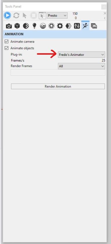

      I updated to the latest Animator and Lib Fredo, and when I click "render animation" in Thea v.4 I get an instant crash and bug splat. Anyone else have this problem? Any advice? Thank you.

          @fredo6 Yes, I tried even with a simple cube spinning 360 degrees. I can render through Animator by selecting Thea but I loose the motion blur so I wanted to render from Thea interface but it crashes every time.
