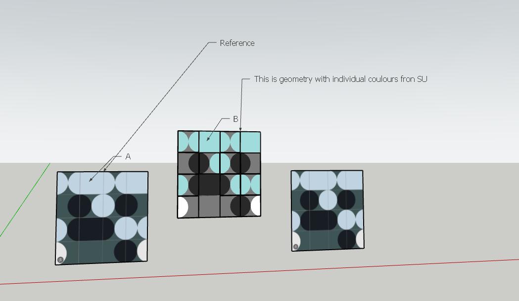

      Hi Guys, in this image I have a reference swatch from the Architect for some complex tiles. I Created geometry an need to get the colour perfect ( I am slightly colour blind) What choices do I have to "pic" colour "A" and apply it to tile "B" Materials.png

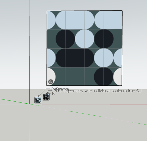

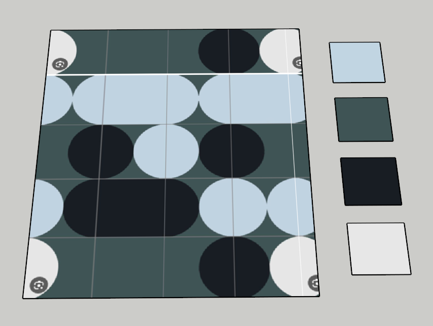

        I worked out how to do it, should have been obvious really. Instead of deleting I thought I would post the solution should anybody else encounters this issue. I simply scaled the swatch to humongous picked the texture and applied it to the tile and moved the texture to the desired effect. It works fine would still appreciate it if there is another way.Enlarged.png

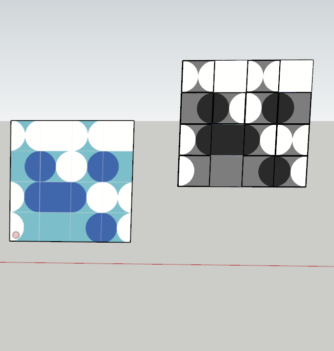

            I have never used that before so I may be using it wrong (probably) This is what i getMatch.png

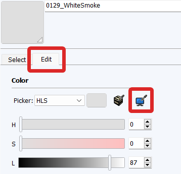

                        Paint any colour on face
                        Use the Edit tab for that colour to access the Match Colour on Screen
                        Now the colour you painted will change to the sampled pixel colour.
