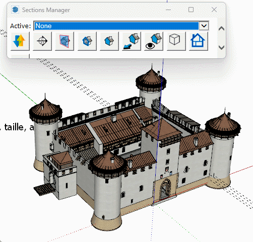

                  Maybe my Section Manager could help you a bit, to easily find, activate/de-activate your section planes.
                  It's free and can be found at the Plugin Store and at the EW.
                  DB

                      @Didier-Bur "I think it's already a good solution, but I was referring to a panel where there's a list of sections with their names, and by clicking on them I can activate or deactivate them by associating them with a scene. It doesn't seem like a complex thing to me, but very useful because, in conclusion, sections need to be paired with scenes anyway, and this isn't possible to manage with any standard SketchUp tool."
                      Didier BurD 1 Reply Last reply Reply Quote 0
