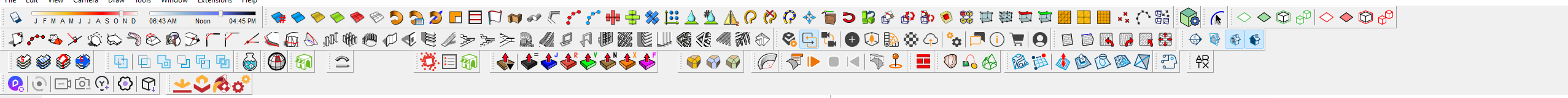

      Screenshot 2024-07-18 154711.png Screenshot 2024-07-18 154643.png Screenshot 2024-07-18 154631.png Screenshot 2024-07-18 154615.png Screenshot 2024-07-18 154603.png
      Hi i have installed fredo tools successfully but they do not showed up in any section of the tools option. I am so confusof what mistep did i make? or was it just a bug???? how to fix it in order for me to be able to use them?? Thank youu
      Please help me anyone i really need thru paint

        Firstly: did you restart SketchUp after the installation ? It's needed to sync Fredo's tools with his Lib etc.
        Secondly: do you have the latest versions of Fredo6Lib and SketchUcation tools installed ?

          @TIG Hi, thank you after i checked turns out the problem is that i havent updated my libfredo. Thank you so muchhh

            You should install Sketchucation Tools too since its required for licensing and it makes install extension much easier
