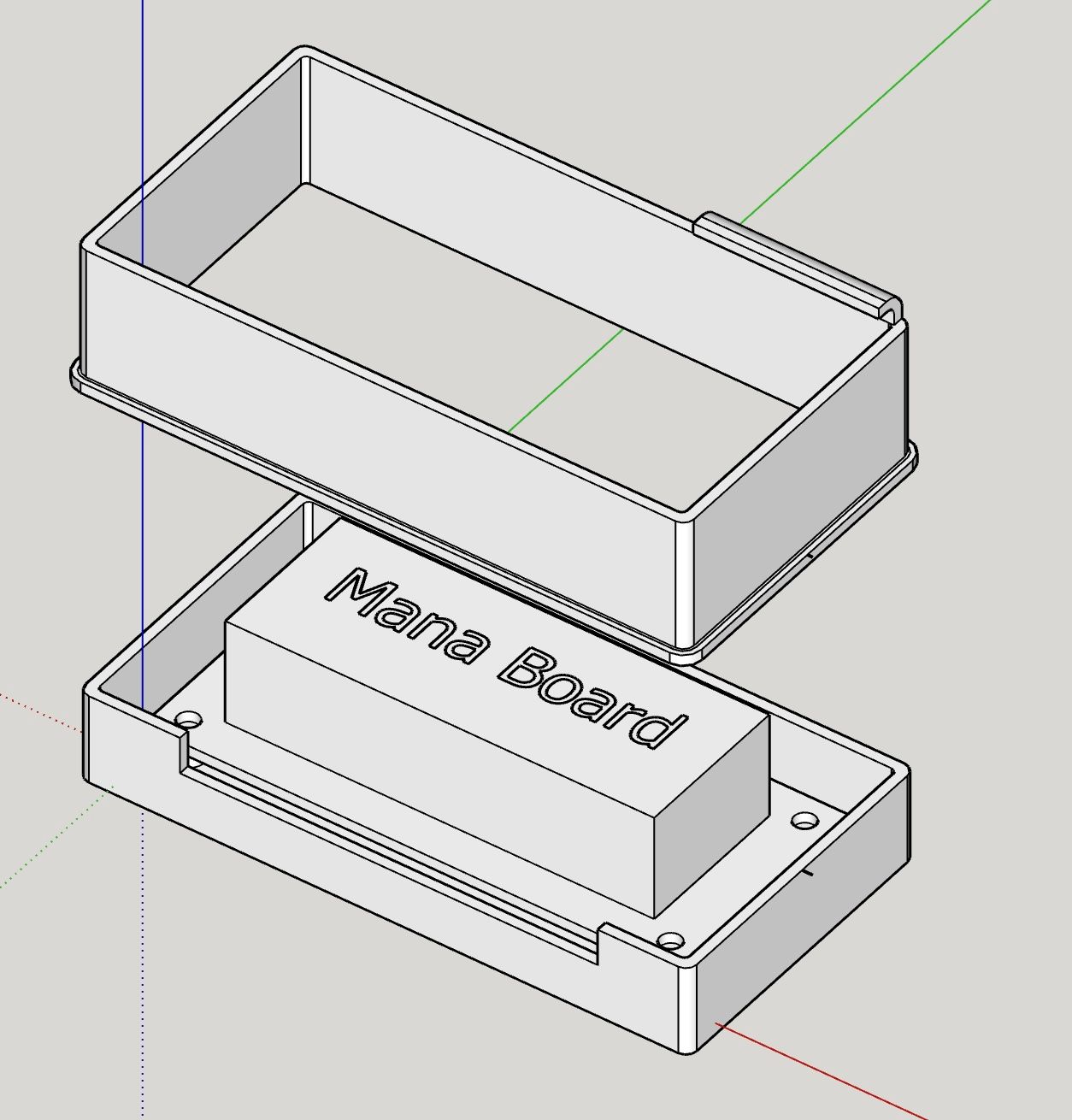

      What I still don't know: how can I guide the rounding on the lid around the corner?

        @Alohaa what are you referring to now? What lid? What rounding?

          Alohaa
          The rounding that can be seen in my first post and that I only managed to draw until the corner.

            Box @Alohaa
            @Alohaa Create a suitable profile and use follow me.

              Alohaa
              ok, I understand the principle.
              What I have some difficulties to understand is the method how you fill the surface.

                Dave R @Alohaa
                @Alohaa Box double clicked on the surface of the large hole which selected the surface and its edges. Then he pressed Delete. The hole was automatically filled in.
