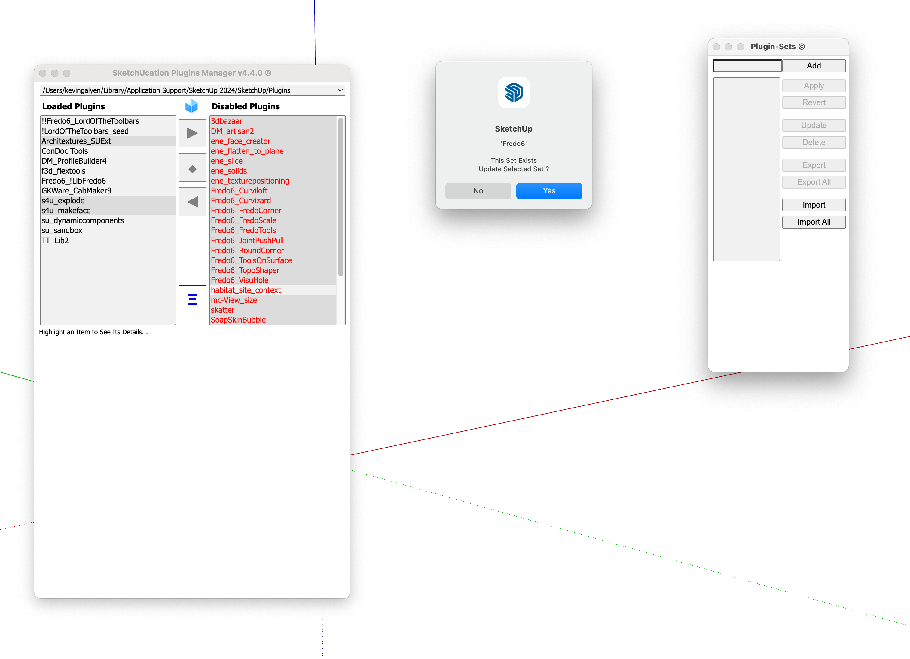

      @TIG I am trying to create the described Sets but am having problems getting them to work. I am on Mac and when I try to create a new set in the Plug-ins Manager nothing shows up in the Sets window. I then try to type the name in again and it says This Set Exists but it is not showing anything. I got it to show once with the Extensions Manager but then it disappears and only shows when I create another new set, then disappears again. How would I go about getting this resolved so it is usable? Thanks!Screenshot 2024-06-20 at 1.27.30โ€ฏPM.png

        @kgalyen Can you upgrade to 4.4.1?

          @Rich-O-Brien that worked. Thank you! Can you clarify for me if disabling them using these managers disables them for the current session or only once sketchup is restarted? Also, disabling them keeps the plugins files in the plugins folder correct?
