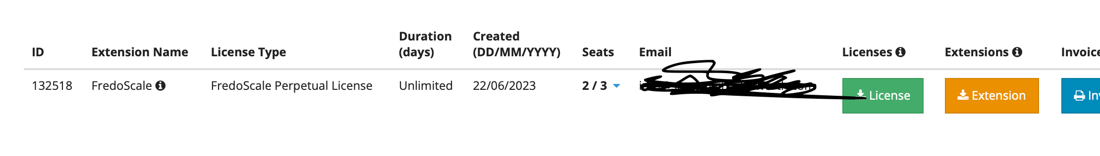

      However on my Sketchucation page it says that all is ok and licensed
