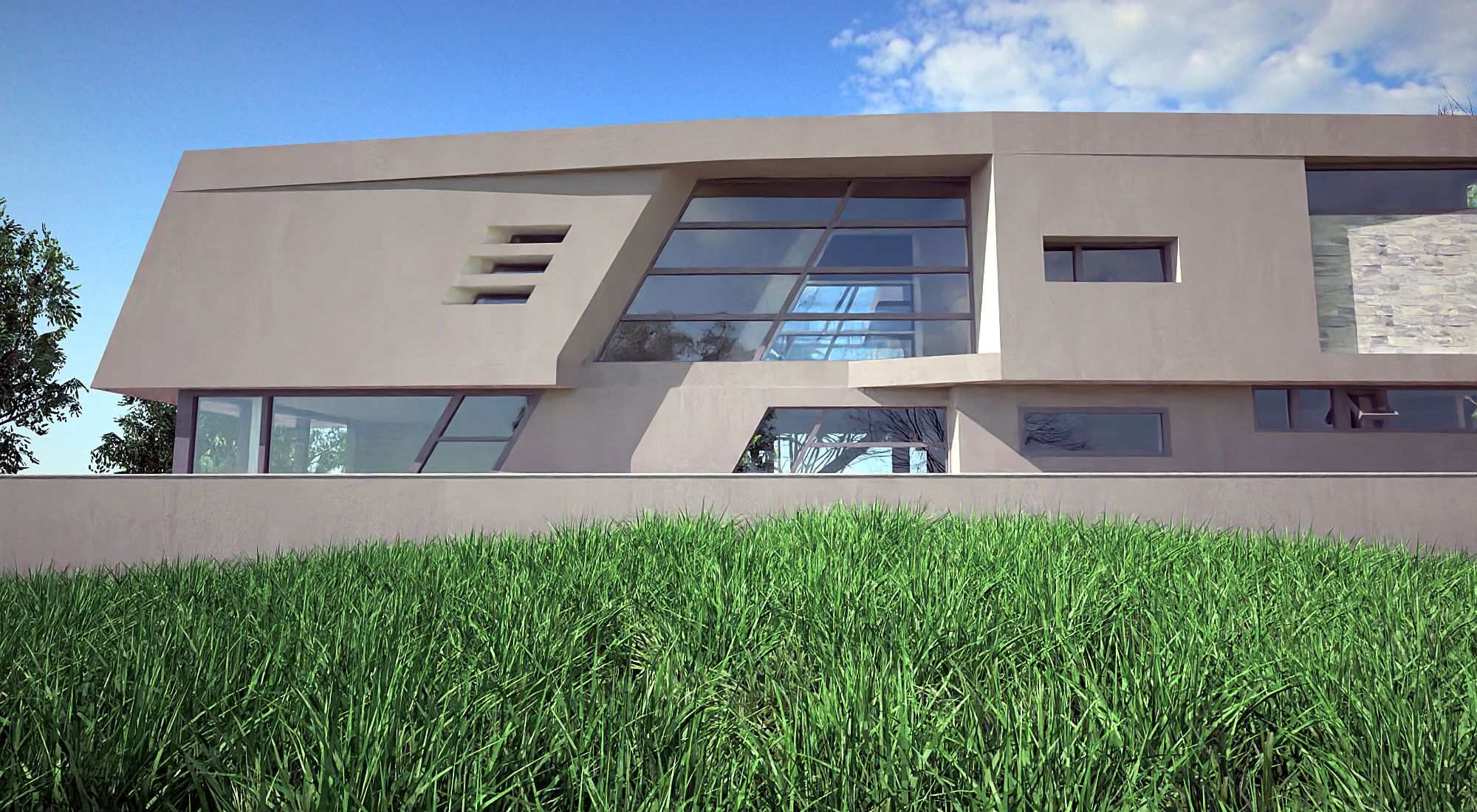

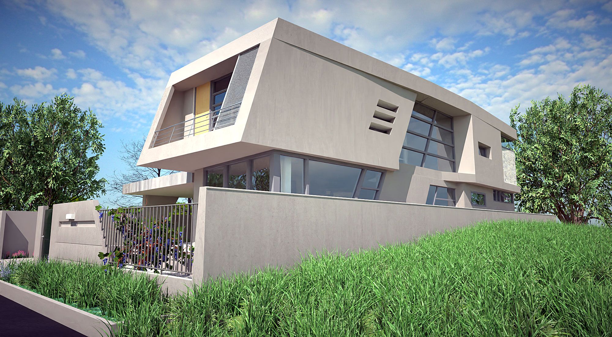

          I used a combination of a 3D model and a "face me "component for grass.
          I made a very simple component ( a square and a vertical line) then included my grass models inside it. The simple one is on one "tag" or layer and the detailed and face me model are on another "tag" or layer. Then made the "heavy" tag/layer invisible to move between scenes,
          This way I can handle grass easily.
