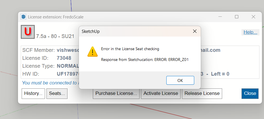

                  vishwesdd
                  iam experiencing the same issue as well. Please let me know how to release all seats for plugin licenses.
                    Rich O Brien Moderator @vishwesdd
                    Please run the Window > Libfredo Settings > Fredo6 Plugins Information for Sketchucation Support menu command in SketchUp and copy/paste the output into your reply.
