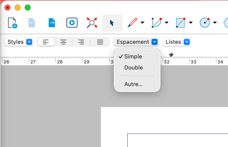

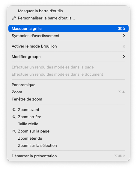

                    • T
                      tibooobit
                      Hi, on Mac, you must first display the rulers in Layout (see screenshot), then select the “Spacing” dropdown menu (see screenshot).
