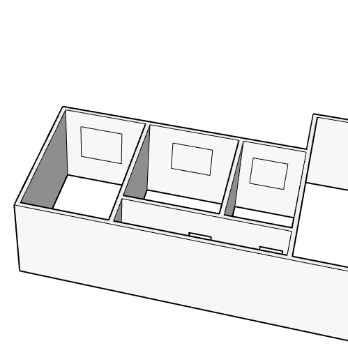

      Hi! I'm trying to push/pull to create windows in my model, but they aren't creating the hole. Instead, it's creating something like a solid passing through the wall. 2021-01-06_183731.jpg file shows the windows I'm trying to create. Modelo.skp file is the file I'm trying to edit.

        It works fine for me.
        Edit the 'container', then activate PushPull, hover over the rectangle you want to form the opening.
        Start to push it into the wall, and move the cursor to snap to the back face of the wall and the opening should form.
        To repeat for other openings in the same width wall, while in PushPull double-click on another face and the opening should form.

          No problems here either.
          I used the corner to set the depth then double clicked to repeat on the others.
