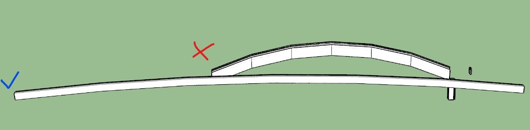

      Hello,
      I created an arch with the follow me tool, an arc line and a square (or a profile), but once it's done, I want to edit de height of the arch without distorting it. My goal is to have the possibility to change it with a dynamic component because it needs to be parametric.
      I have searched for a while and I can't find anything that could help me. So is it possible ?
      Thanks for you help !

        Editing the size of the thing will require scaling. If you can figure out how to modify the height of the arch using the Scale tool, you should be able to manage it in a dynamic component. How do you intend to use the arch component you create?

          I tried the scale to but I don't understand how to avoid the change of thickness of the arch.

            That's the challenge of using the Scale tool. For what you describe, I think I would just make each arch for the pool cover as a separate component and not spend the time trying to make it dynamic. It's not difficult to use Offset to create the side of the arches and then extrude them to thickness/length.

              Ok maybe I'm not clear enought. I could do each arch manually but the goal is to start from the same one and "generate" the others by copy and use a formula for the scale.
              Even if it's not necessary to "generate" the others arch, there the need to change the width of the whole pool cover so every arch will change their heigth without changing the thickness, and their width (which is not causing much problems).
              For me the context is not really important here, I don't know how to explain better, the question seems simple to me.
