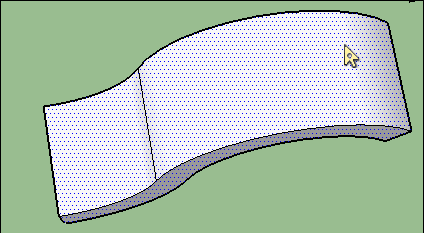

          Why not use directly Visuhole ? ๐Ÿ˜‰
          Here a flat top face, but you have an option for curvated ones! ๐Ÿ˜‰
          https://i.postimg.cc/RZx5HRbX/GIF-vihole-curvatedgif.gif
