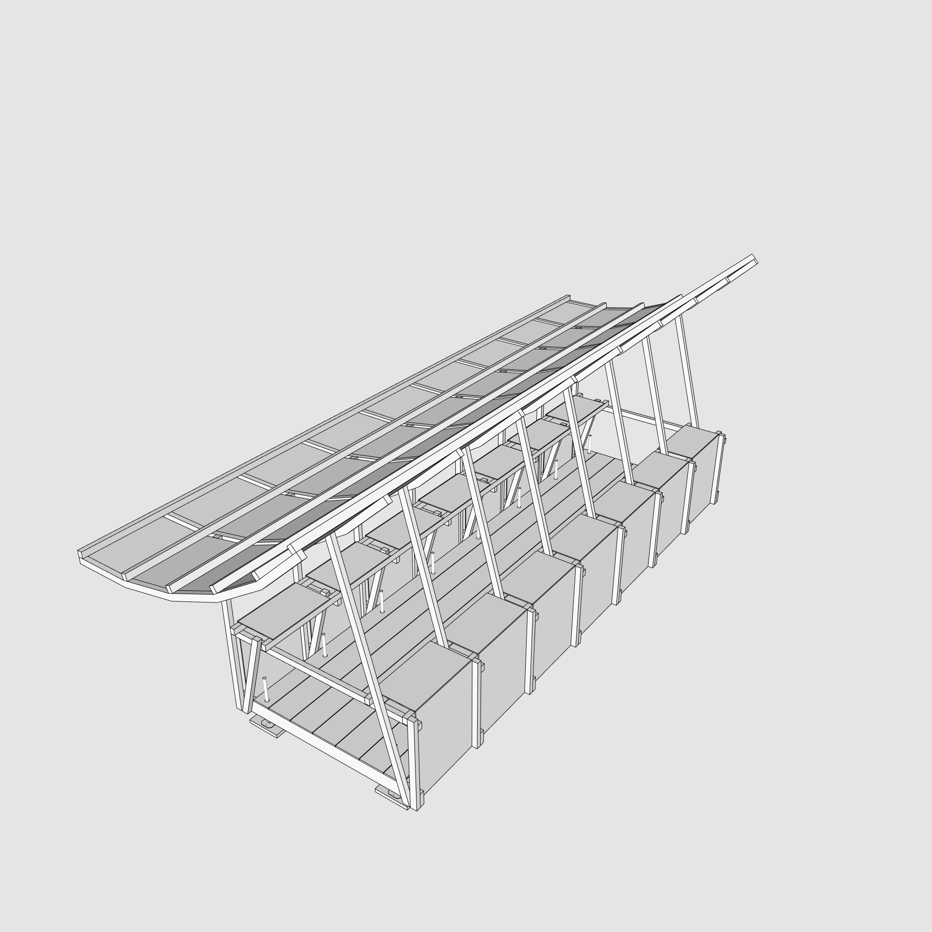

                                          Hello! I have the same problem. I created an animation with Animator (v4.5a) two days ago, it worked fine. Today when I opened the file to make adjustments, parts of my model (the roof) had moved up, and the animation no longer works. When I move the objects down where they should be (the roof should be on top of the structure like so), and then go back in Animator, it seems the position changes I just made are cancelled. I’m uploading the file as well as a screenshot of the desired shape. I should say that I’m using the trial version of SketchUp Pro 2025, which seems pretty unstable, on macOS Sonoma 14.4.1 (23E224), Apple M1 Max, 64 Go. I would be grateful to anyone who can offer a solution! Thanks
                                          250728-Sceno animation.skp

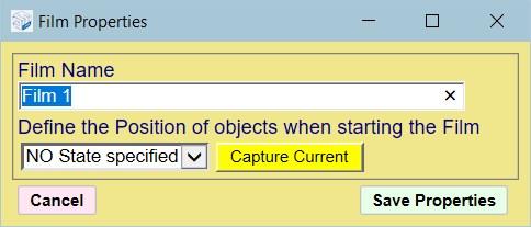

                                            Object positions may change for a lot of reasons, sometimes depending on when and how you save the model.
                                            The best is to use the Positioner (4th icon in the toolbar) to record the initial position of all objects of your animation film. Then, you can recall this position at any time.
