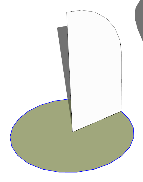

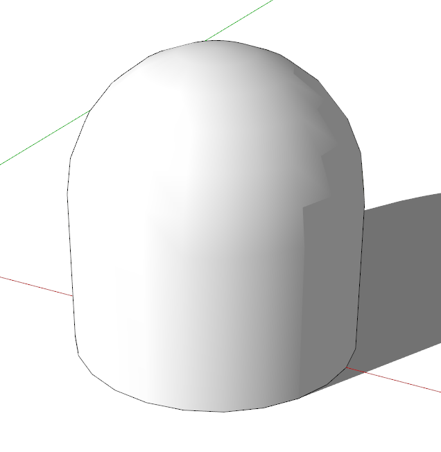

Is this like what you want to end up with?
If so, you need a different approach. Start with this. Select the edge of the circle, get Follow Me and click on the vertical face.

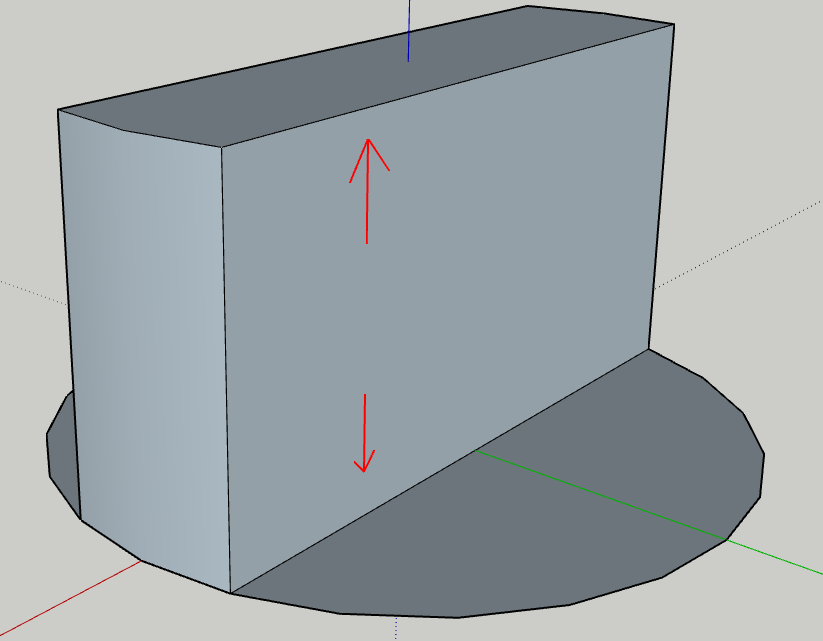

Dave Thanks for the reply. I still need the middle area as is, i just want to put a small radius on the top and bottom edges so its not such a hard line
Oh. You can use Fredo's Round Corner for that.
