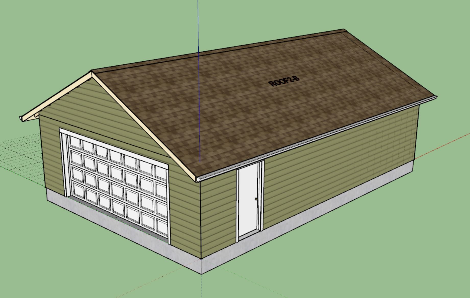

                          Here is what I prompted ChatGPT with:
                          Okay, now that you have helped me actually program most of the Medeek APIs (wall, truss, foundation and floor). I would like for you to attempt to use the API to generate some ruby code I can dump into the console in order to create a simple garage (four exterior walls) with a simple fink truss roof.
                          I also forgot to add that this should have a slab on grade foundation that measures 24' x 36'. The walls align with the edges of the foundation (outside of framing) and the truss roof will also be 24' x 36'. On the one gable end will be a 16' garage door 84" in height (default, so don't worry about the height. On one of the long walls there should be a regular 36" x 80" door, centered 6' from the corner. On the other long wall a 36" x 48" window (centered on wall) and on the other short wall opposite the garage door wall should also be a 36" x 48" window (centered on the wall). The fink truss roof should be a 6:12 pitch, leave everything else as default.
                          After one mistake (it put the roof assembly on the ground initially, not sure why it missed that but it did), it produced this piece of code, which I then copied and pasted into the console and hit enter:

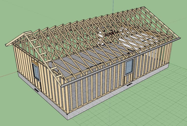

                          The result was this:
                          ChatGPT just built (in SketchUp) my new detached garage in under five minutes. It was even offering to modify the windows to sliders and other modifications if I needed to stray from the defaults that I had used.
                          These AI engines will continue to improve and eventually they may be able to do much more than design a simple four wall structure like this. Things are going to get really interesting in the next couple of years.
