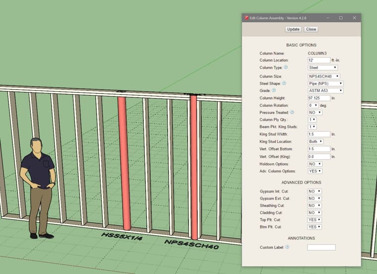

                            Version 4.2.8 - 01.27.2026
                            • Added the following steel column types to the column module: Round (HSS), Pipe (NPS).
                            Update per customer request.
                            You can now add round steel in-wall columns into your Medeek walls. These aren't actually lally columns since that specific product is typically installed with an adjustable screw assembly. However for most design purposes I think showing the round column like the image above will suffice.
                            Lally Columns
                            Custom Sizes & Wholesale
                            Budding Co (buddingco.com)
                            Nathaniel P. Wilkerson PE
                            Medeek Engineering Inc
                            design.medeek.com
