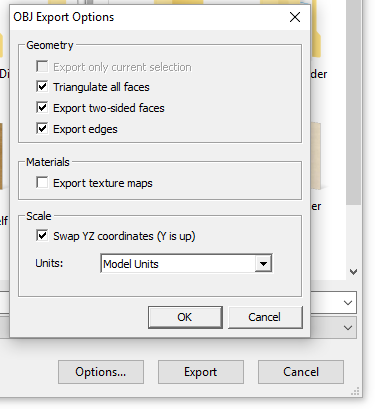

        See this from the SketchUp Help Center: Exporting OBJ Files.
        Click Options and untick Triangulate all faces.
        By the way, your first two screen shots from SketchUp show all the faces reversed. You should be making sure that all front faces are visible and back faces are inside the 3D shapes.

            Sadly the link you sent are for Sketchup Pro users, I am using the free version Sketchup Make 2016. With the obj plugin for Make 2016 it does not give us the "OBJ Export Options" like the pro version gives you. It just gives the option to save with converted textures into PNG files or not.
            I tried reversing the faces so they are the correct way, and it does nothing to the exported OBJ file. Still adds why too many edges.
            Any other ideas?
