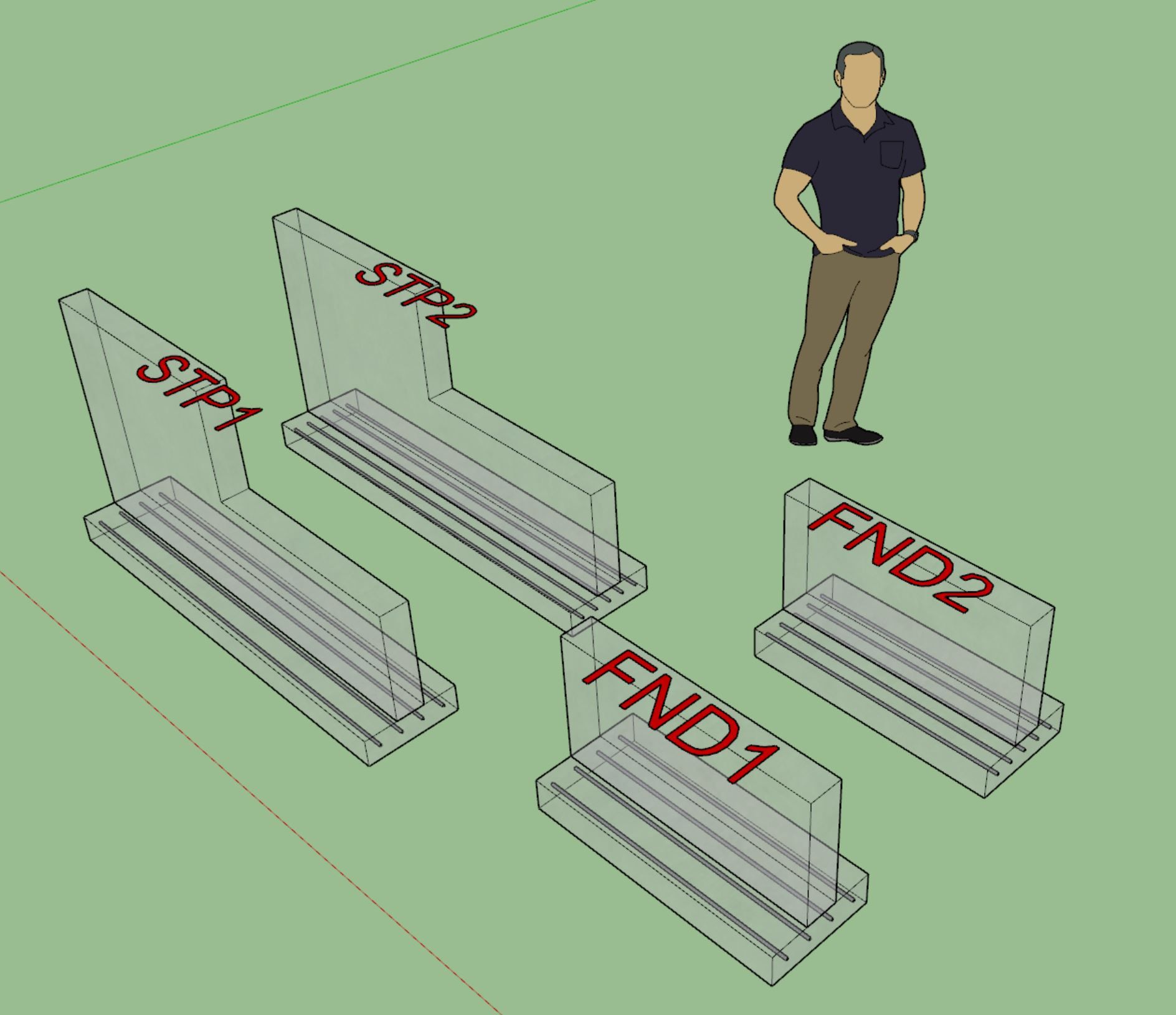

            Version 2.1.0 - 03.05.2026
            • Enabled quantity 4 and 5 bars of footing rebar for stemwall and stemwall step foundations.
            This update per customer request.
            I did not update the legacy stemwall tool since I will be retiring that tool eventually but I have not decided on a date just yet.

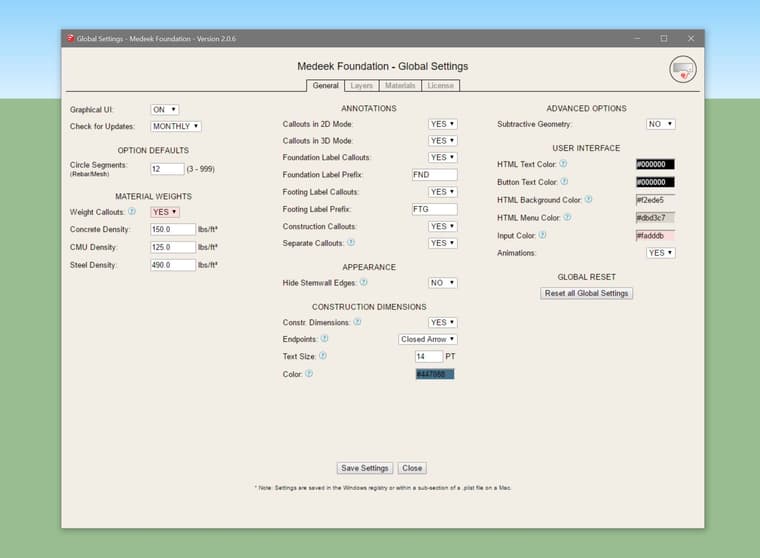

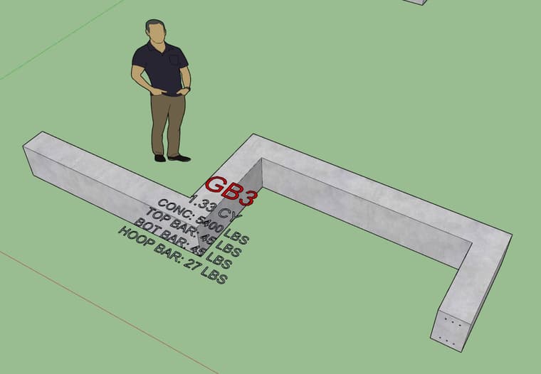

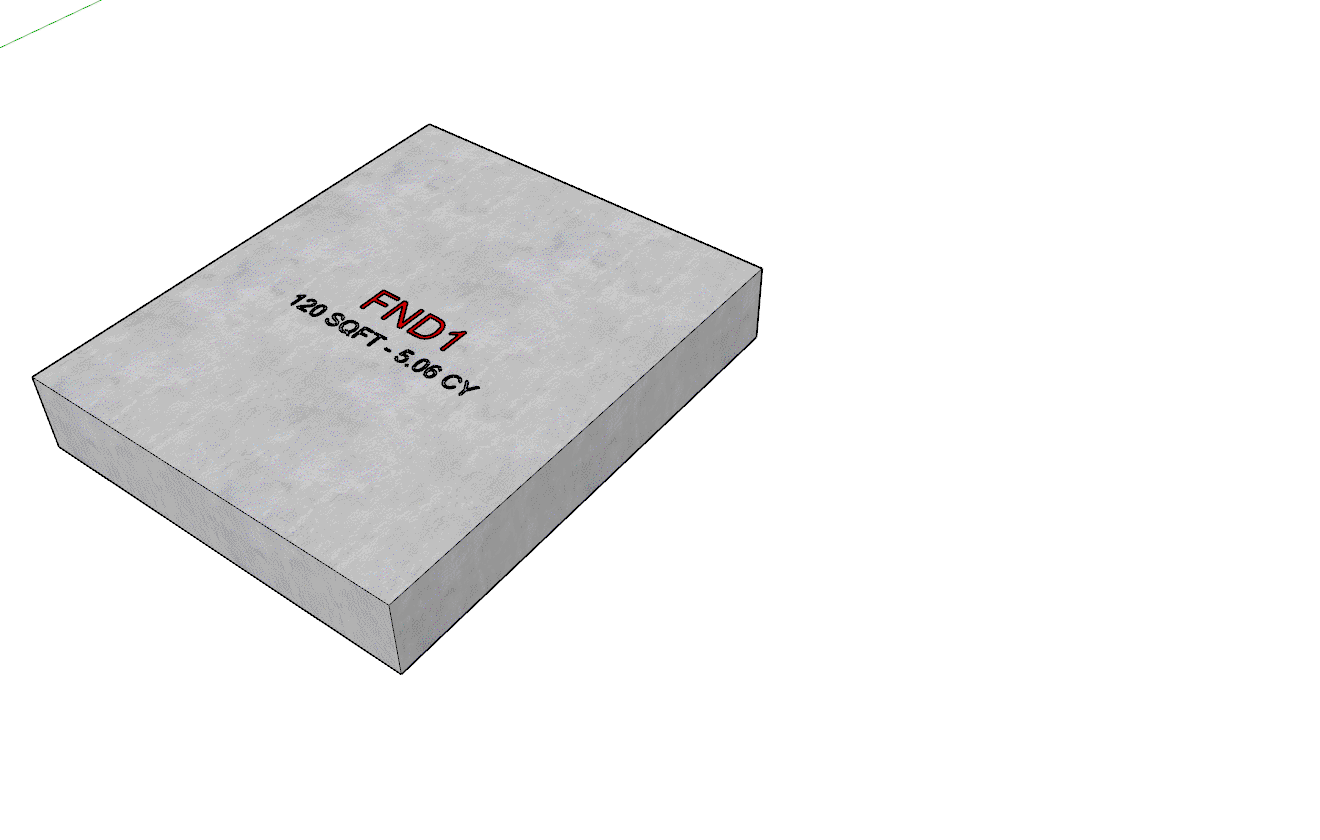

              Version 2.1.1 - 03.06.2026
              • Added a "Material Weights" section to the General tab of the Global Settings.
              • Added Weight Callouts as an option for grade beam assemblies.
              The density of the concrete, CMU and steel can all be customized in the global settings as shown in the image above. I will probably enable this feature for other foundation assemblies if it is requested.

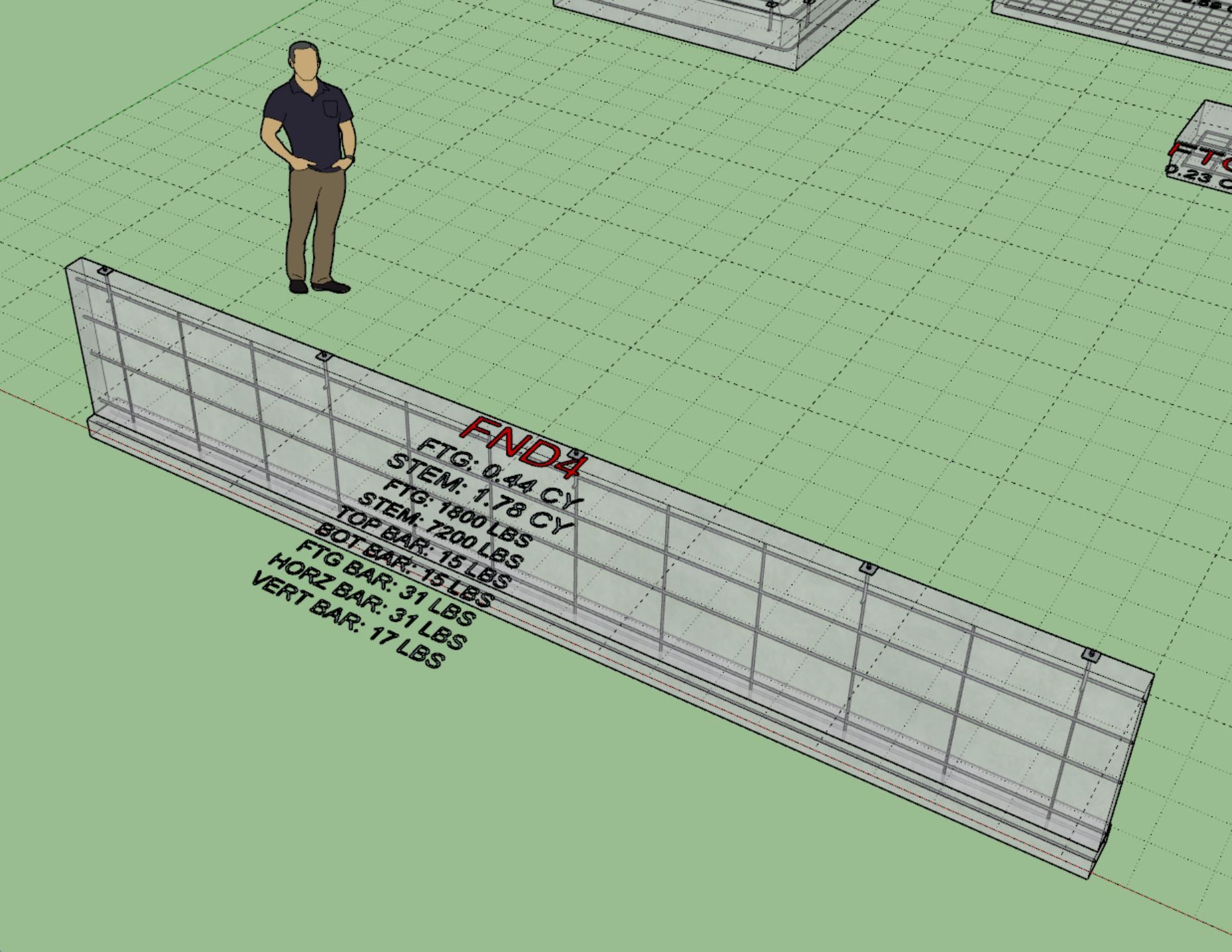

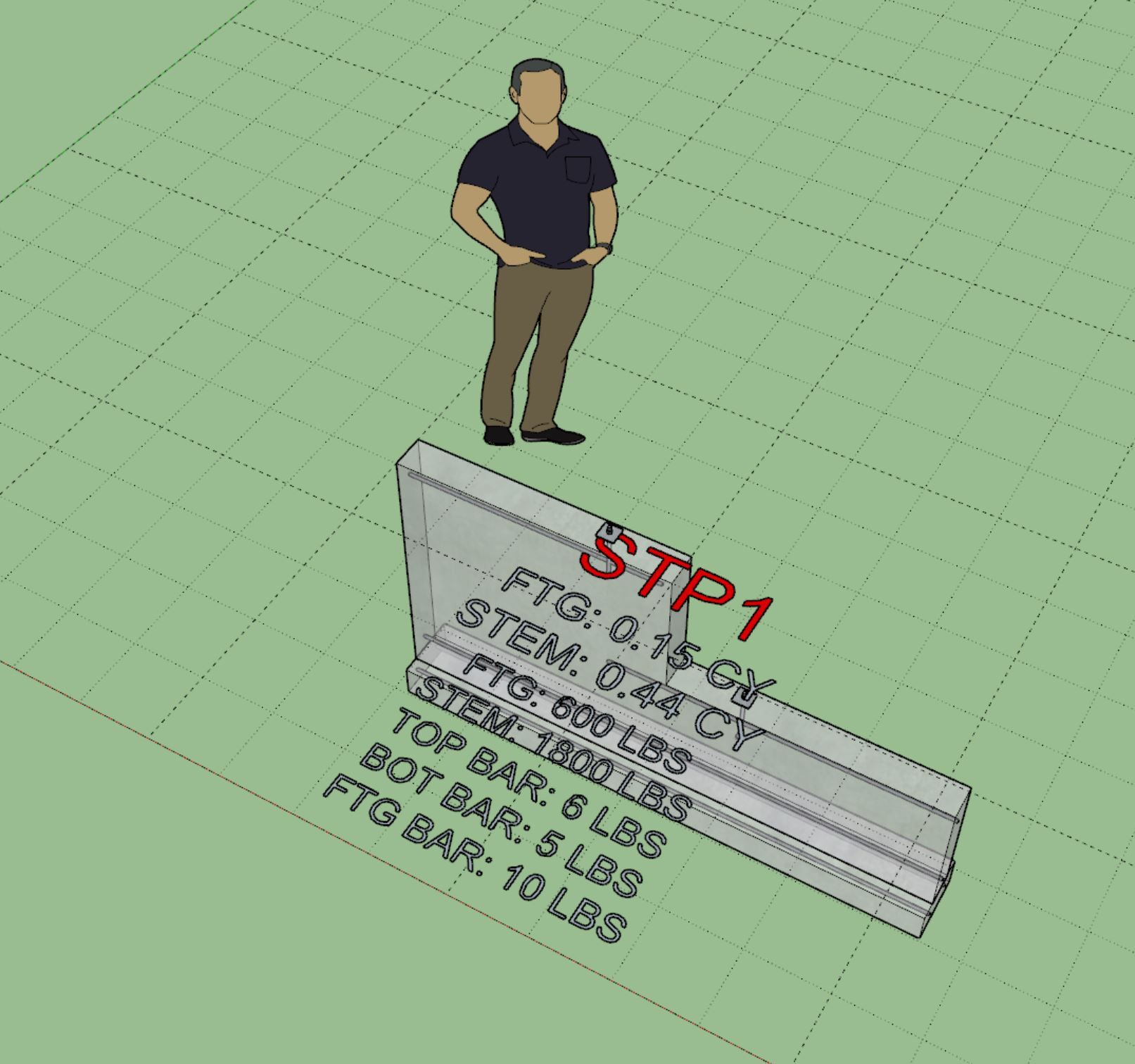

                • medeekM Offline
                  medeek
                  Version 2.1.2 - 03.07.2026
                  • Added Weight Callouts as an option for polyline stemwall assemblies.
                  • Added Weight Callouts as an option for stemwall step assemblies.
                  For this detailed breakdown you need to have the "separate callouts" and "weight callouts" both enabled.
