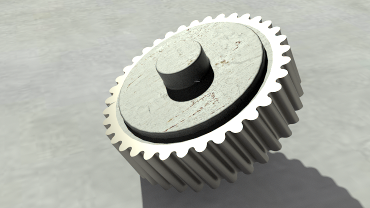

          No need for curviloft, just make gear tooth pattern, push-pull and rotate (twist) bottom edge 5 degrees.
          Of course, there are gear-making plug-ins 😎
          [attachment=0:bldmc5gc]<!-- ia0 -->Gear.png<!-- ia0 -->[/attachment:bldmc5gc]

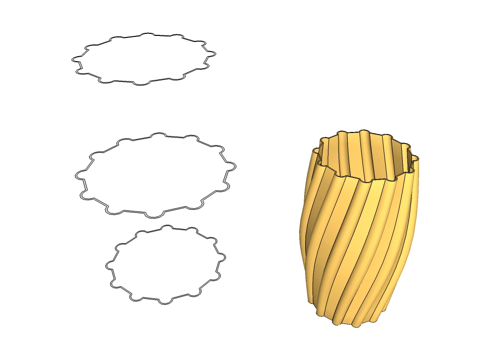

            Now that I understand just what your trying to do here's a way to get there. The steps you do are from left to right in the picture.
            Draw your "sprocket". Make a hole in the center for the inside wall. Make it a group. Copy the sprocket up, I did it twice. Scale the sprockets to give the vase taper.
            Use Curviloft - Loft by Spline and select the inside edges of the sprockets to get the inside of the vase. Do the same selecting the outside edge of the sprockets for the outside of the vase.
            Use Joint Push Pull to give the bottom of the pot thickness.
            Use Fredo Scale Box Twisting to twist the vase. Twisted the sample 20 degrees.
            One tip , Work BIG, the model is 4' tall, then scale down. Colored vase in front is a more realistic 12" tall.

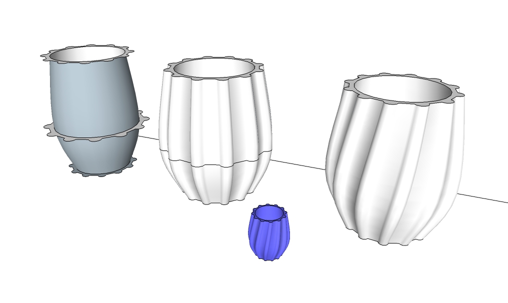

                      Not sure why your trying to make your model like this. I'm no expert at 3D printing but have been researching and reading up on it of late. As I understand the process on an object like a vase the thickness of the print would be the distance between the inner and outer wall of the model. It just seems that would be the logical way to make an object like a vase so it's walls are solid. Seems like your trying to model it so there would be a hollow cavity between the inner and outer wall ? If it's trying to cut down the amount of material used I've posted a pick of another vase. The inside follows the contour of the outside. It's actual thickness would be determined by the requirements of the printing material used. As a side note both models I posted check out as solid and could be printed.
                      If your determined to keep trying what you've been doing. Try using JointPushPull on the outer surface before you twist the vase. After the twist the geometry is insane and it's asking a lot of JPP to try and pull thickness on something with that crazy of geometry. If JPP works before the twist you could group everything and then give it the twist. Remember work REAL BIG !
                      One last thing if you haven't already, you might talk to a 3D printing service for the best way to approach this.
                      Oh and if your wondering I scaled the vase down before I saved the image. Sprockets are at the size I did all the modeling.

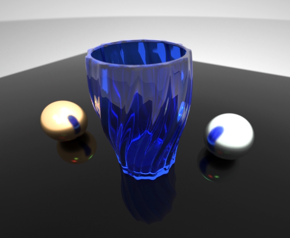

                              Here is a vase sort of like yours. I made it with plugins you probably don't have. But the point is, even with curviloft you get the inner and outer surfaces, and you need to complete the top and bottom. I don't do printing but I think this would print because when grouped SU says it is "solid". It just has the surfaces continuous with no holes and no extra faces or edges.
                              Made this with push pull (and duplicated the base curves several times), Vertex tools, and Artisan (to smooth it).

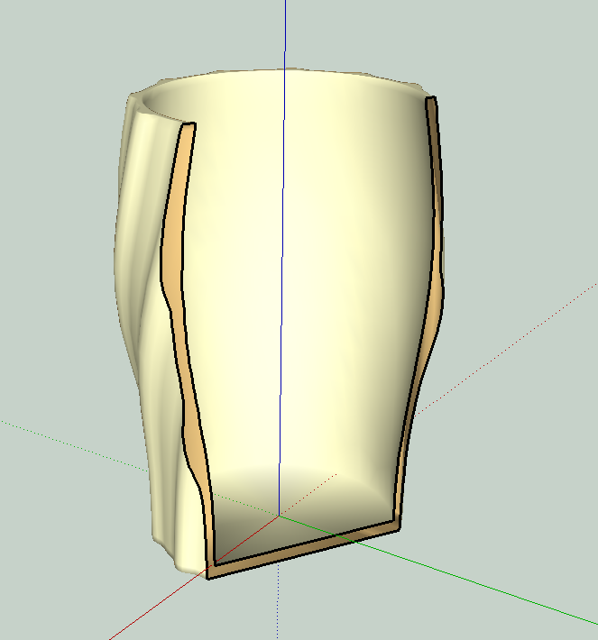

                                Okay, so I guess the reason my vase is not a solid must be due to the curviloft then? If I push/pull the base profile and then run SolidInspector, I have to fix some reversed faces and internal faces (no hole in face like with curviloft below), but then I do get a solid. If I run Curviloft and then Solid Inspector though, I get the following errors. The hole in the face is Solid Inspector thinking the top of the vase should be covered like a jar...:
                                I attached my sketchup file in case anyone is interested.
                                sprocketVase_curviloft_new.skp
