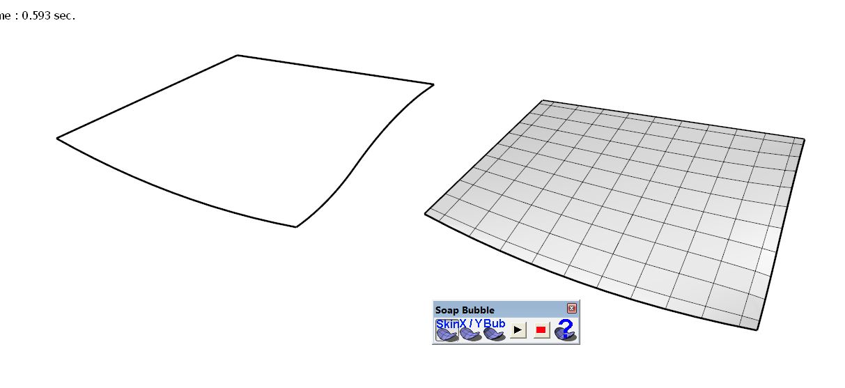

      How to make this surface on top (its clear)?

        just one possibility could be the use of the "Soap Skin & Bubble" plugin

          Your question is: I have the border curves, I want the shape?
          Extrude tools by TIG should do it nicely.
