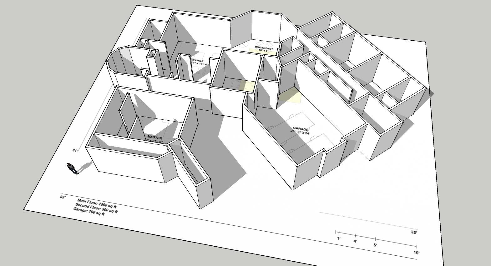

      In this example, the top image where I trying to use the push/pull tool on the right side of the dining room is behaving correctly. The bottom image where I have selected the left side of the dining room is selecting all the adjoining rooms even though all the edges are connected. Does anyone know why this is happening and how I can fix it?

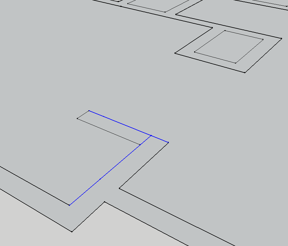

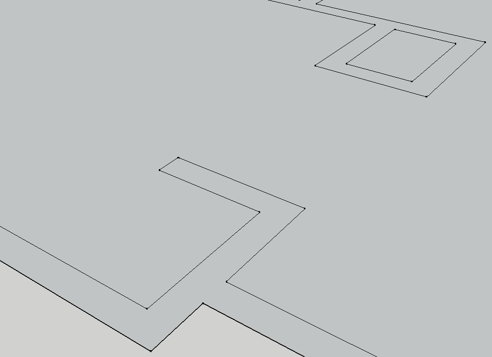

                Well, I got the walls separated from the floor by redrawing some lines that were split and deleting the unneeded line segment that crosses the wall. There are some other lines that ought to be replaced with single lines, too.
                You can see the profile edges inside the perimeter disappear and you have just the normal weight lines instead.
                Before you extrude the walls, delete the floors or you'll have reversed faces on the walls and missing faces on the bottoms of the walls.
