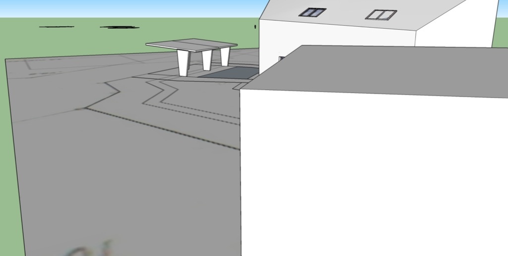

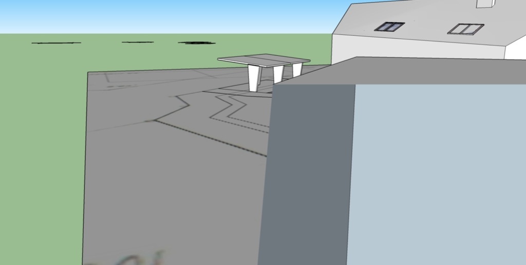

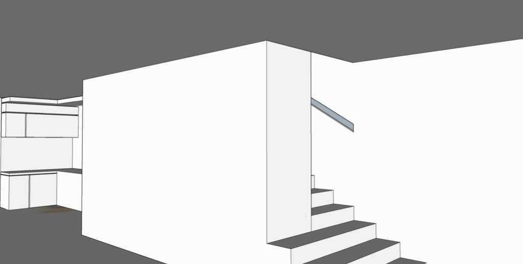

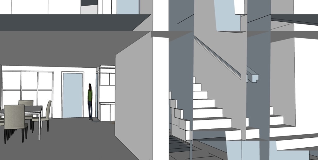

      The problem is that i cant finish my sketchup model of semidetached house because of some sort of ,, invisible cutting surface" that is next to camera in small distance. It is hard to explain. I attached few photos that shows the issue.
      Did I set some wrong setting accidentally?
      Im sure that my computer works correctly(its new). I working on windows in SketchUp 2014.

        Hi, that is called camera clipping.
        Have a look here for possible causes & solutions.

          It worked. The most helpful verse was that one about models distance from origin point. I found a very little, lost piece of a model far away from origin point, deleted it and now everything works perfectly.
