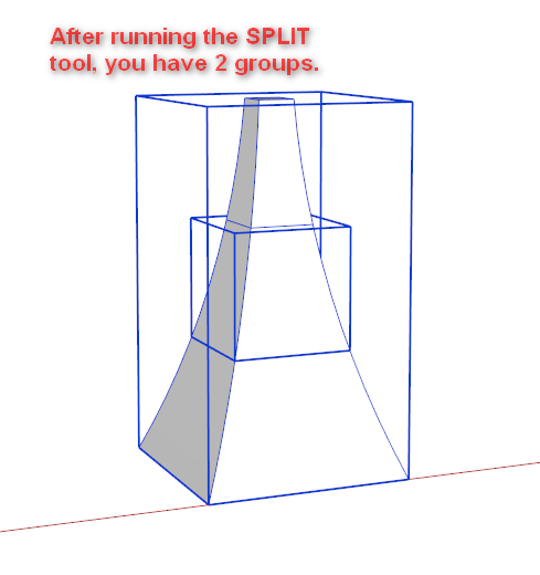

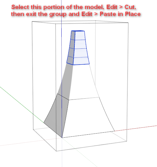

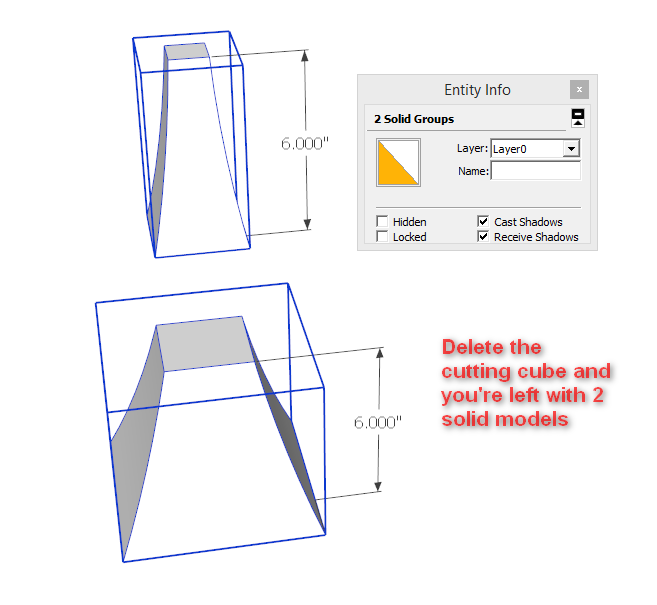

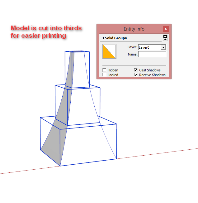

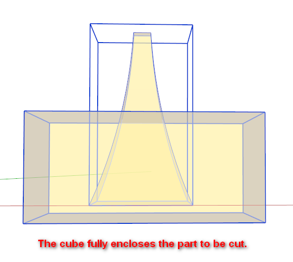

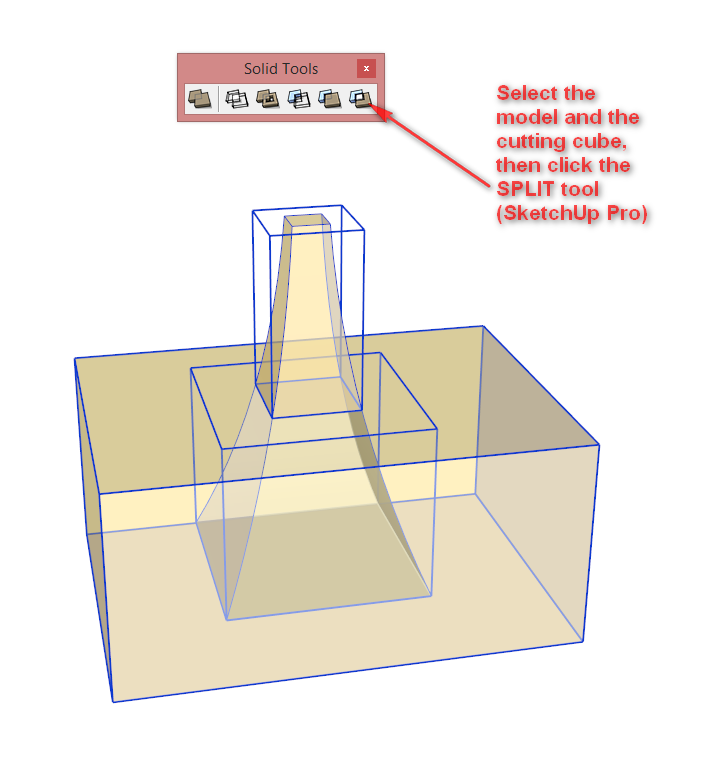

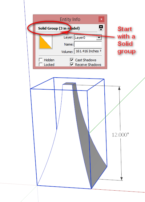

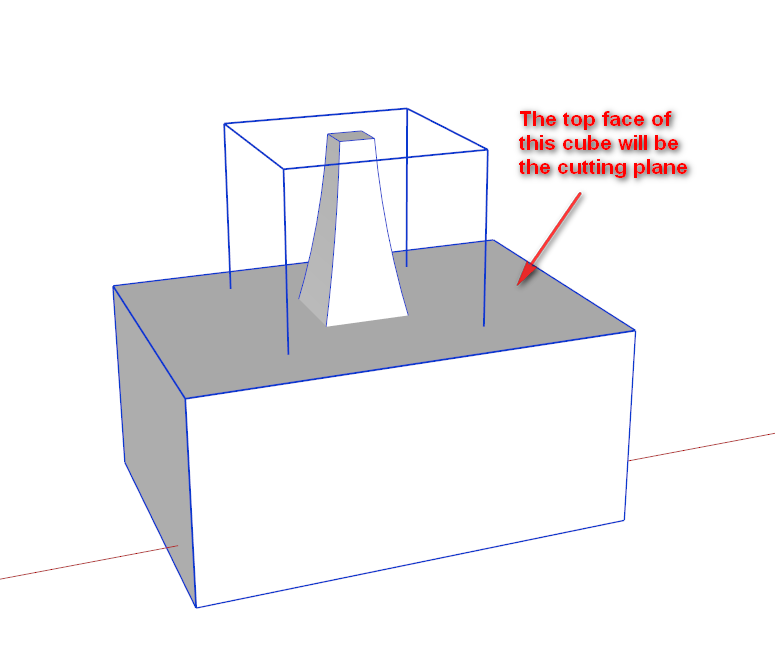

          As an addition to what kaas says, it looks like you're using Pro, so you can use the Split function of the Solid Tools and a dummy cutting cube to cut up your model, something like this:
          SketchupSplitModel01.PNGSketchupSplitModel02.PNGSketchupSplitModel03.PNGSketchupSplitModel04.PNGSketchupSplitModel05.PNGSketchupSplitModel06.PNGSketchupSplitModel07.PNGSketchupSplitModel08.PNGSketchupSplitModel09.PNG
          The model is attached if you want a closer look.
