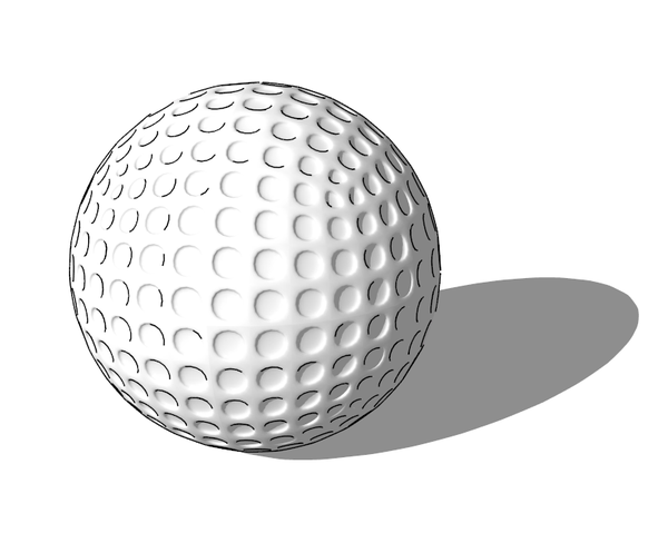

      @box said:
      If you downloaded that one from the 3D warehouse it won't print the dimples. If it is the one I think it is it is nothing more than a smooth sphere with a golfball texture applied to it.
      If you want the full shape and writing to be 3d printable then it all needs to be modeled.
      Yes that's exactly what i want. Yes i do have that 3D model from the Warehouse. Can you explain me how to model that?
      • KrisidiousK Offline
        Krisidious
        You're going to do some math or find some math already done on the dimple size and location. then use that info to draw spheres and offset them into the needed location and the intersect the geometry to leave your dimples. Make sense?
          It does, but can you explain to me step by step how to do that? If possible?
            Something so complex isn't easily achievable in SketchUp without investing a sizeable amount of time.
            golf-ball.zip
            Look at the attached file to see when even using components the size in quite large at ~5MB.

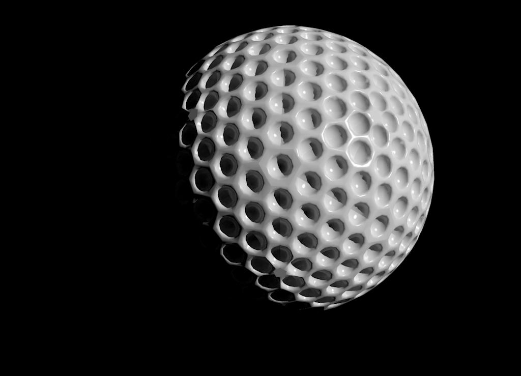

            • gillesG Offline
              gilles
              Search for geodesic, Taff Goch...
              Also: http://sketchucation.com/forums/viewtopic.php?f=79%26amp;t=40505%26amp;hilit=+golf#p358716
              Here is one you could use, to make it printable (solid) explode nested components (may take some times), and rescale.
              GOLF.skp

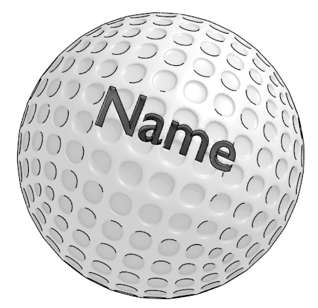

                [attachment=2:2rqg3jmz]<!-- ia2 -->golf-ball.zip<!-- ia2 -->[/attachment:2rqg3jmz]
                [attachment=1:2rqg3jmz]<!-- ia1 -->Clipboard-1.png<!-- ia1 -->[/attachment:2rqg3jmz]
                That's exactly what I need. And now along this line i've drawn I want to be able to put a name there. And with that name I want it 3D printed.
                  Off you go an do it πŸ‘
                  • C Offline
                    Chmaaoges
                    @rich o brien said:
                    Could you also explain that to me? I haven't found my way around Sketchup that good..
                      Tools > 3D Text
                      Type Name hit enter
                      Scale to size
                      Subtract text from ball
                        I forgot that Solid Tools is a Pro feature. If you haven't Solid Tools then you can purchase Boolean Tools of the free Boolean plugin floating around here.
