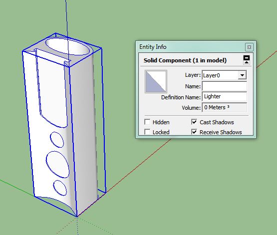

          Here's a 3 minute version by eye that is a solid. Have a look at the construction and compare it to your own.
          Edited to replace with a SU8 version

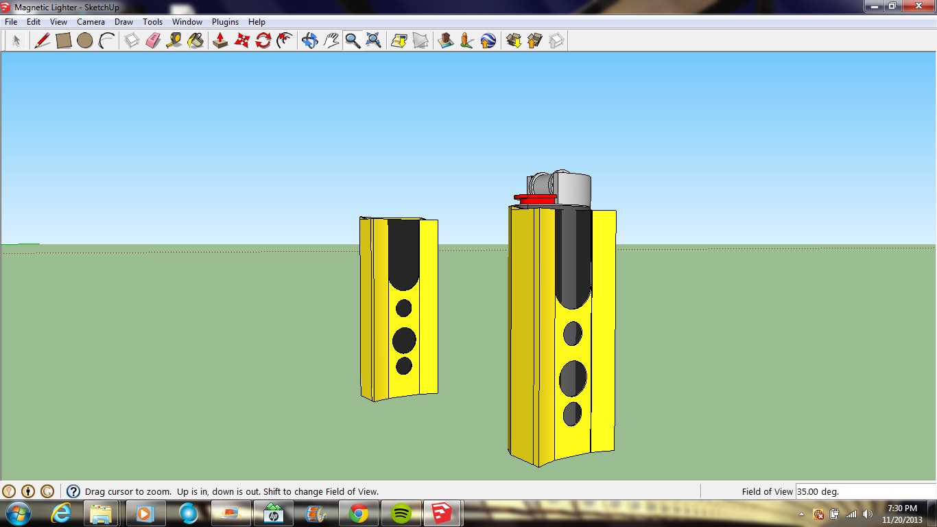

            All I can say is WOW! I go to bed hoping my post will get looked at and I wake up in the morning having all of the answers I need! I can't believe how well this forum is setup with all the great community members. I now have a much better understanding off Solids and can make my next ideas a solid from the start. I cant thank enough for the help BOX!. Taking the time to make the solid for me is amazing even though that is something very simple to most of you. Teaching myself it took me hours to make my simple lighter holder.
            I am attaching the model so if something comes to this forum they can open it and see the mistakes I have made. Box do you mind if I take your perfect rendition of the lighter holder and print it now so I can start on my next invention! 😍
            Drawn with separate as lines instead of a solid

              You are certainly welcome to use it but I would point out I only did it by eye, so I doubt it would fit a lighter.
              It really needs more work to make it nice and the right size. On your model the top is different, mine is just flat.
              For the cost of printing it you may as well make it right.
              I had a very quick look at your model and it is fixable, but I'm busy right now. I'll have a look at it a bit later assuming someone else doesn't pop in and fix it up for you.
              One important thing I noticed straight away, you have some faces reversed. The bluegrey default colour is the back and white is the front, they need to be the right way around for things to work properly. In other words, all the inside faces of your solid should be bluegrey and the outside should be white.

                Your model has two problems:
                • internal faces
                • bottom with no thickness
                If you repair these, it's getting solid... (see screencast)
