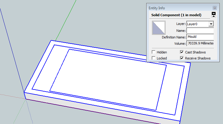

      Hi guys, i new to SU and need some help.
      In my drawing you can see it rectangular shape with lower levels. I want to cut out some pieces with the subtract tool, but it keeps saying my shape is not a solid or it is "locked". Ive tried fixitSolid plugins and nothing seems to work.
      The red rectangles are parts I want to cut out. The top red mark is a cut out I want to make flush with the lowest level.
      Someone please help!
        An image isn't much help because we can't see what it is that is preventing your group or component from being considered solid. Post the SKP file instead.
        Your profile indicates you are using the free version but the Subtract tool is part of Solid Tools which is a pro-only feature. Which version are you using?

          skp file attached.
          If I build a rectangle and pad up, I am able to use the solid tools, but that is only on basic shapes. Idk which version I got, I was linked this via shapeways haha
          Hopefully you can help me with this problem, I've been trying to find a solution for the past 3 hours ๐Ÿ˜ž

            Based on your uploaded model, all you need to do is select all of the geometry and make it a component or group and SketchUp it'll be shown as "solid". Did you try that? At the upper left of the screen it should tell you whether you are using pro or Make.
              well i feel stupid, i originally had 3d text on my model, so i guess that was the problem -_-
                Oh. Well that wasn't shown in the file you posted either so I didn't know that.

                  Since there are only flat faces, pushpull should work too to make the holes without the need for a solid ...
