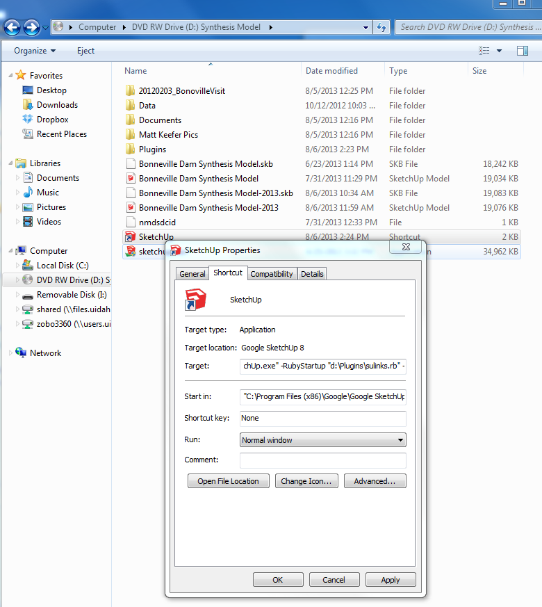

                When I went to distribute the model with shortcut to open the plugin I needed to use, the plugin did not work! I think that I know what the error is:

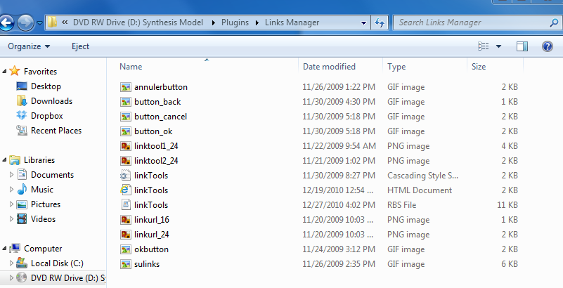

                The plugin needs to be unzipped into the C:\Program Files\Google\GoogleSketchup8\Plugins folder. The ruby script that I am calling in the shortcut defines the icon for the plugin, but does not run the functional part of the plugin with the .rbs file type. This functional part is in the Plugin folder, in a subfolder! I tried to modify the .rs file to call the correct file path to where I am storing the plugin on a disc drive, but I believe the correction needs to be made to the encrypted file. What to do? Here is a breakdown of my attempts:
                Shortcut properties
                Here is the file structure of what I call the functional part of this plugin.
                plugin subfolderfunctional ruby script
                I really like your plugin, but I don't want the users to have any options between the buttons... I need a little simpler interface for the user after I set the files. Your plugin was exactly what I need as the designer, but then I need a little plugin that can just open the file location or weblink without editing power. The LinksManager plugin almost does that...the user has to Ctrl+click on the component to follow the link.

                  • zobo3360Z Offline
                    zobo3360
                    I agree!
                    I am using the LinksManager Plugin by Dieder...His instructions on using the plugin require that you unzip the file into the Plugins folder. It will not work to copy and paste the folder into the Plugins folder. ThomThom recommended that I try to open the plugin from a sketchup shortcut using an argument. It creates the icon. But because the encrypted part of the plugin does all the functional work, I can not modify it to look to another drive for the files. (The error I get when I run the .rb part of the plugin in the ruby console is that the .rbs is undefined). I am thinking it will be best to try and create one .zip package that contains everything I need to distribute, and puts it into the Plugins folder so that I don't have to remap the location of the .rbs file.
