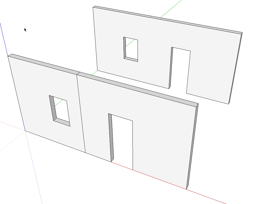

        Open the groups for editing and get the Eraser tool. While holding Shift, click on the lines you want to hide. Repeat as needed on other groups.
        Before in the foreground, after hiding in the back.
