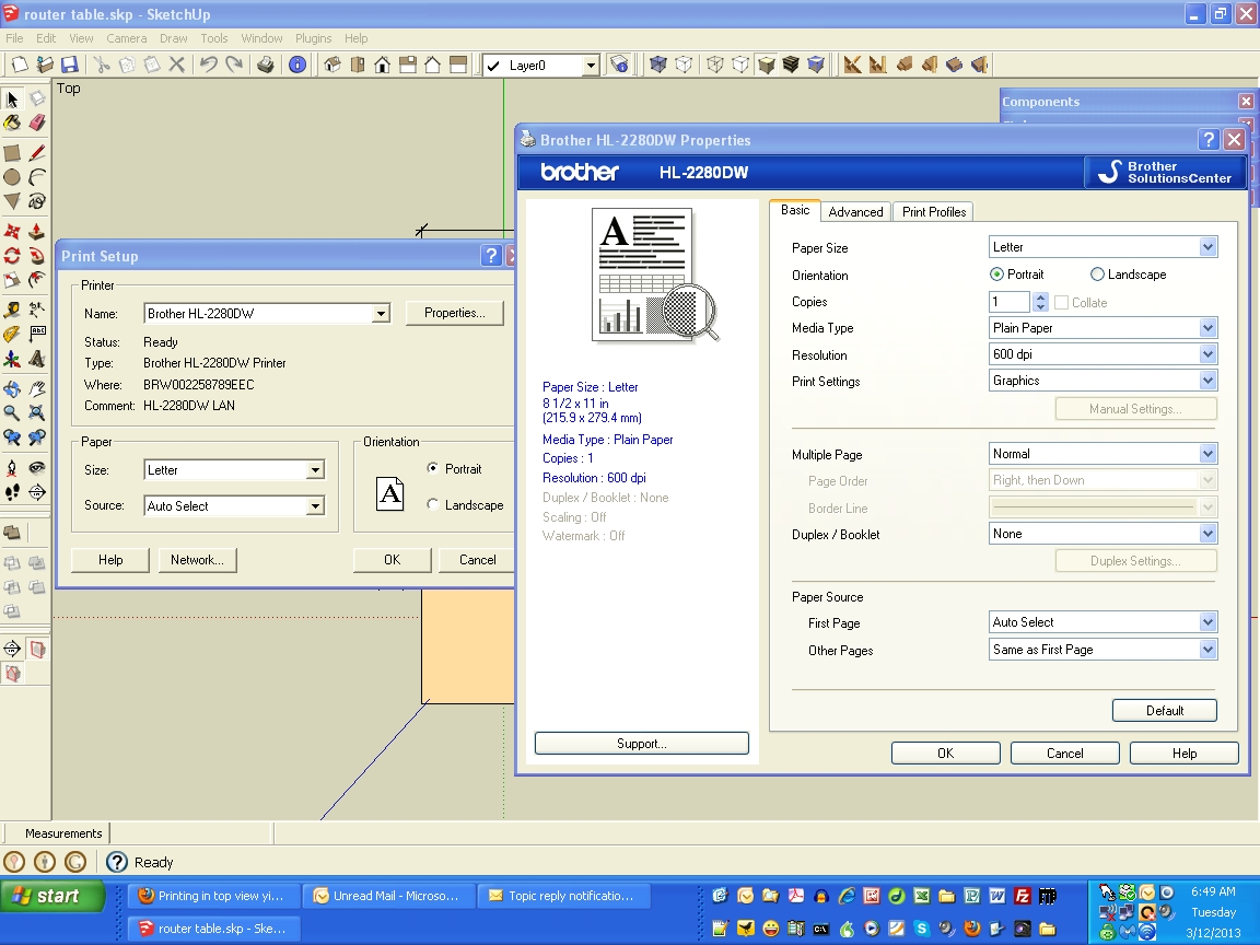

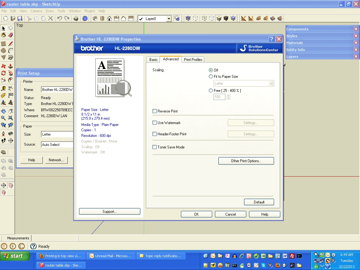

          Two screenshots showing the Basic and Advanced settings. The Print Profiles tab is a place to create profiles and I have never used it - all should be at default settings.

            Are you printing directly from SketchUp? As in File>Print? There should be a dialog box I don't see in your screen shots.
            • B Offline
              bartgragg
              This one?
              HAHA!!!! Now I see the issue - I unchecked the "Use Model Extents" box and all is right in the land!
              Did you see anything else?
              Thanks for the nudges, Dave.
                That's what I wanted to see. Looks like you're all set now.
