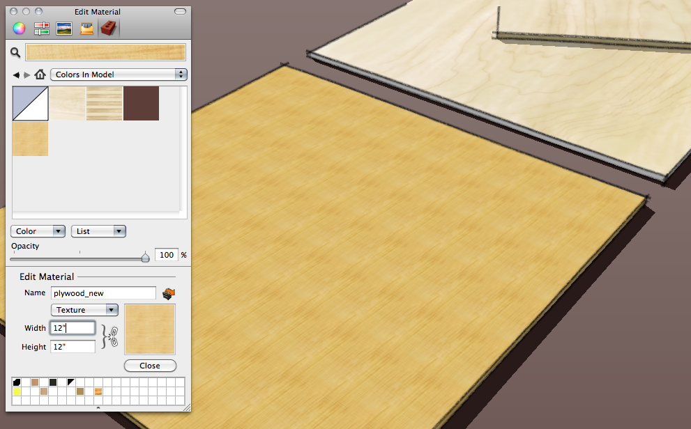

                I was looking at the SKM file you uploaded.
                Notice the dimensions that show when in Edit mode for the material in SketchUp. 12 x ~3-51/64".
                When I create materials from images, such as my plywood image in the background, I create a face with the dimension or the "board" and then use File>Import to import the image as a material and apply it to that face. Doing it this way automatically correctly defines the dimensions of the material.
                It looks to me as if you just need to edit the dimensions of your material now that you have it in SketchUp. Break the link between the Width and Height so you can edit one without changing the other.
                Here I've edited it to make it 12 inches square. I don't know if that's the area you intended it to cover, though.
