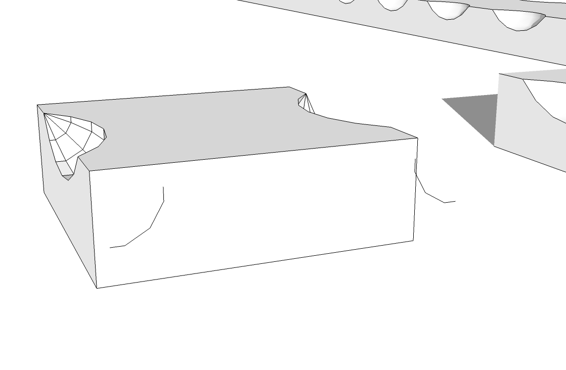

Hello, i am new to sketchup and I'm trying to remove curved pieces from the edge of a rectangle. The project is a steel railing with a hammered effect along the edges.
My problem is, as i use the follow tool to create the back wall of what will be my 'dented' area of railing, the edges of the back wall dont fill in. They always remain transparent and i cant seem to find any way to fill these in.
I will attack an image to show you what i'm getting at, The problem area is marked with a red arrow. can anyone help?
thanks
Maybe the whole model is too tiny (SU has issues with creating small faces). Try to scale it up by 10 or even 100, do the job and if it fills, you can scale it back (SU will support already existing, tiny faces).
Thank you very much. now it's looking much better. there are TINY little gaps but my model is simply for illustration purposes so this will be great.

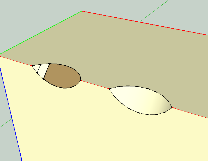

Here's another way you might approach this.
First, the arc for the edge of the hammered dent doesn't need to be all that smooth. It's going to be a very small detail in an overall view of the railing. Not worth "spending" a lot of geometry on it.
In this view you can see the arc I drew for the edge of the dent has 6 segments instead of the default 12. Up close it doesn't look very pretty but wait.
I also used Follow Me which works fin IF the first segment of the path is perpendicular to the profile. the last segment in the path must be perpendicular to where you want the profile to stop. In this case it is the side of the railing. For the path, I drew a 12-sided circle centered on the edge of the railing. I rotated it so there were sides positioned horizontally and vertically. Then I drew a couple of line segments to break the edge of the circle at the midpoints of these sides and deleted all but the quarter circle arc. Note the short segments at each end.

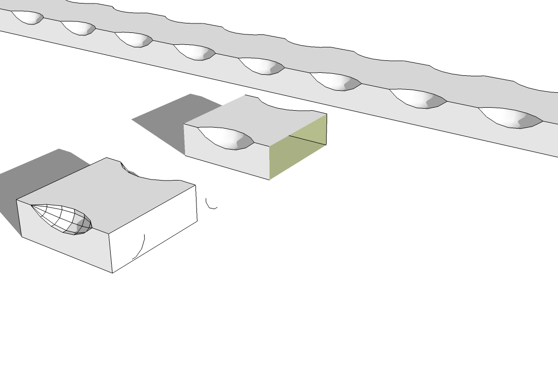

Next was the Follow Me operations to form the dents.
I only made a single pair of dents in a very short section of the rail. This then became a component. the end faces were deleted as you can see in the middle of the next image. The edges surrounding the ends were hidden.
Now, using Move/Copy, I can make a rail whose length is any length that is a multiple of the segment. Of course by making the end components unique, their length can be edited without affecting the rest. You could modify the length of the dented component to adjust the spacing of the dents and you could add non-dented sections or other shapes at the ends if desired. It's light as far as the entity count and file size is concerned. It's flexible in its use and once you've made the component, you don't need to make those dents again.
