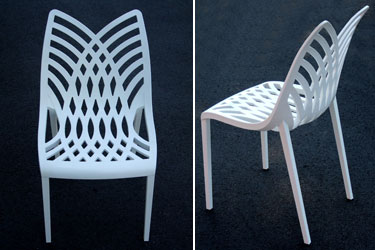

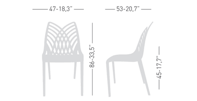

      I'm new here. I've only been using Sketchup 8 (Free) for a month or so. I have a project I need to do on Sketchup- there are some chairs I need to model that are an integral part of the design; the only problem is I have no idea how to model them.
      Can someone point me to a tutorial or give me some instructions as to how to make the chair in the attached images. I was hoping there might have been a pre-made one in the 3D Warehouse but I couldn't find it
      Thanks so much

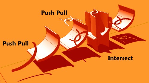

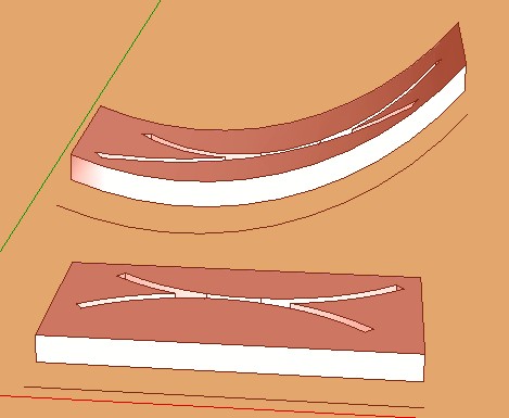

        Maybe like this ?
        or with Shape Bender by Chris Fullmer?

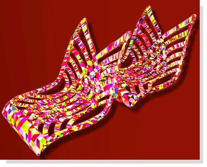

          here's a start on it.. it has some mistakes but i don't feel like starting over to correct them πŸ˜‰
          maybe throw some legs on there and call it a day..
          chairseat_6.skp
          dotdotdot
            thx for the v7 πŸ˜‰
            So what was the method used ? πŸ˜„
                Wow that looks amazing! Thanks- I really appreciate you taking the time to do that.

                  Maybe like this ?
                  [attachment=1:2gwkkhw7]<!-- ia1 -->chair.jpg<!-- ia1 -->[/attachment:2gwkkhw7]
                  [attachment=0:2gwkkhw7]<!-- ia0 -->Shape bender.jpg<!-- ia0 -->[/attachment:2gwkkhw7]
                  That method will definitely come in handy! Thanks.
