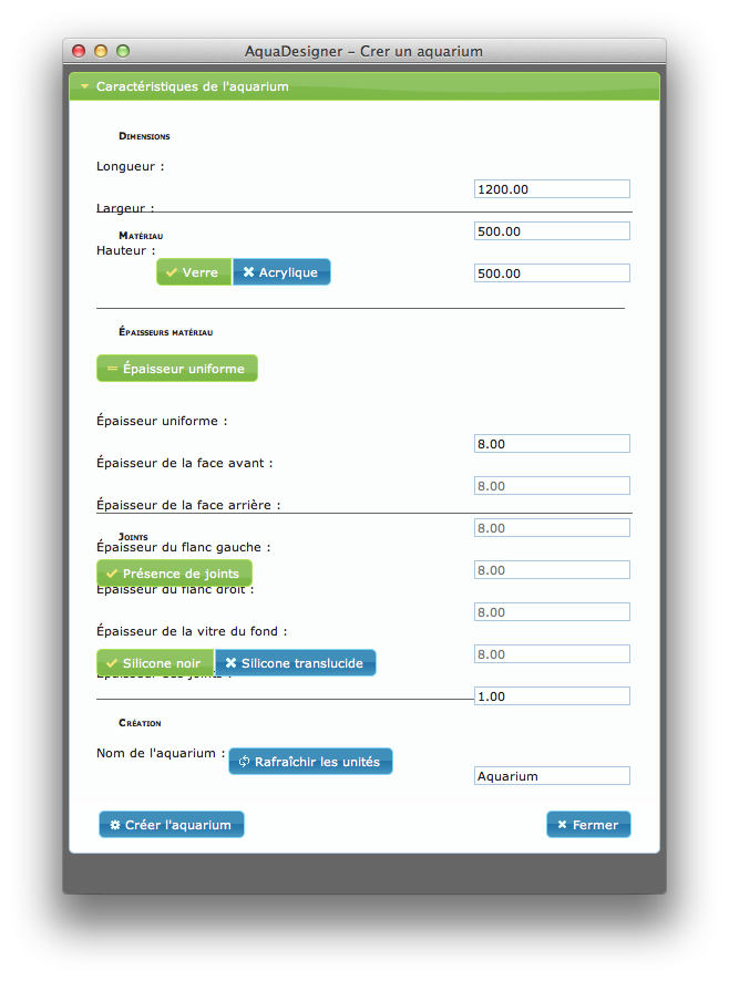

                                      • D
                                        driven
                                        if I change the rubies encoding to uft8 and I zapp the gremlins I get this which shows the css for font size is not good. use ems
                                        learn from the mistakes of others, you may not live long enough to make them all yourself...
