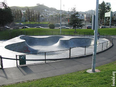

    How do I model skate parks - bowls - pools?

        curviloft and/or extrude edges by rails. no artisan. a good pool need accuracy.
        you make me want to go out and ride those pools instead of being in front of a pc 😑
