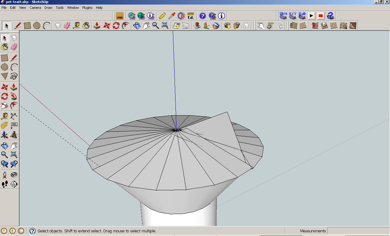

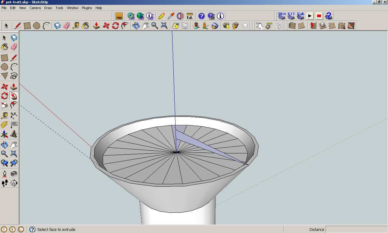

      The first follow-me-action resulted in an edgy, ruff shapeHello everybody
      I'm new to using sketchup and right now I'm having some problems using the follow me tool -
      I think I'm getting too few sections while making circular shapes, which makes the results edgy and
      prevents me from using the follow me too to create the last top-part (look at the printscreens I included).
      I've tried to read some other threads about this problem without getting the hang of it.
      My goal is to have a seemingless, smooth end-result!
      Please help me out! I'd really appreciate it!
      The ruff, edgy shape prevents me from creating the top part = everything gets messed up

          Hi, Jean
          Thanks for the input. Prevoiusly I've had some problems with the linetool snapping just beside the main axis
          (We're talking micro-inches off the axis) and maybe it's my lack of experience using sketchup but I find it
          very hard to locate this errors and correct them without sketchup snapping at the wrong point. Any suggestions
          about how to "stay on the axis" so to speak? And avoid those problems?
          Also, it seams like smoothing each edge of the triangular segments recuire quite some time (or "clicking"). Is there a way
          to speed up that particular workprocess?
