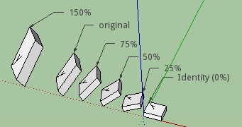

          Shouldn't it be possible by interpolating the transformation with an identity transformation?
          I did a quick test, but the API method Transformation.interpolate didn't work for me, so I wrote my own
          def interpolate(t1,t2,percent);a=t1.to_a;b=t2.to_a;c=[];16.times{|i| c[i]=percent*a[i]+(100-percent)*b[i]};return Geom;;Transformation.new(c);end
          ![transformations.jpg](/uploads/imported_attachments/hr97_transformations.jpg)

            This is a clever way to interpolate all values but if you just want to interpolate the rotation it will also scale etc ?
            If the base tr is un-scaled 1,1,1 and the second tr is scaled in the X -1,1,1 - then won't it try to use an invalid scaling factor of 0,1,1 for the interpolation of '50%' ? 😕
