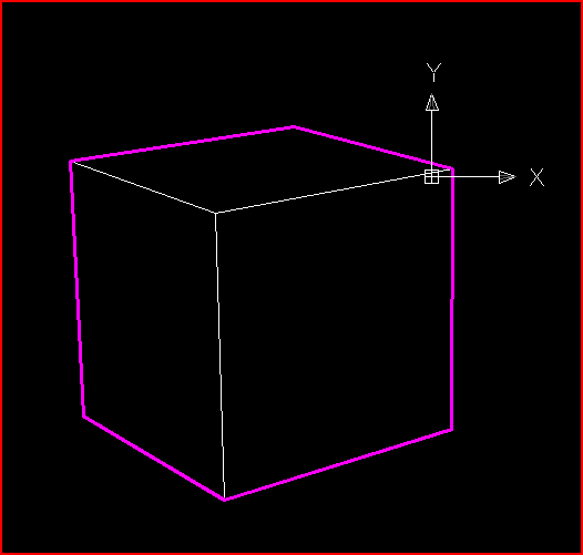

              • TIGT Offline
                OK...
                NOW it's clear...
                It's NOT an option for a 3d DWG export - there its faces/edges etc.
                If you export a 2d DWG it is an option.
                However, then the viewed objects are reproduced 'flatten' onto the camera plane.
                The ProfileEdges and SectionCutEdges CAN be exported as lines on their own separate layers.
                However this is now a flat 2d object, with all other edges on Layer0.
                It works for me. πŸ˜•
                What settings do you have for the export options dialog ?
                The reason for including a 2d snapshot is to allow 'flat' DWGs to be made of 2d views plan/section/elevation views, losing hidden lines and having 'profiles' etc shown separated for CAD or illustrator apps use later.
                Using it for a 2d representation of a '3d view' is still OK, but of course very limiting...
                2d with lines + profiles only
                2d options - showing profiles + sections
