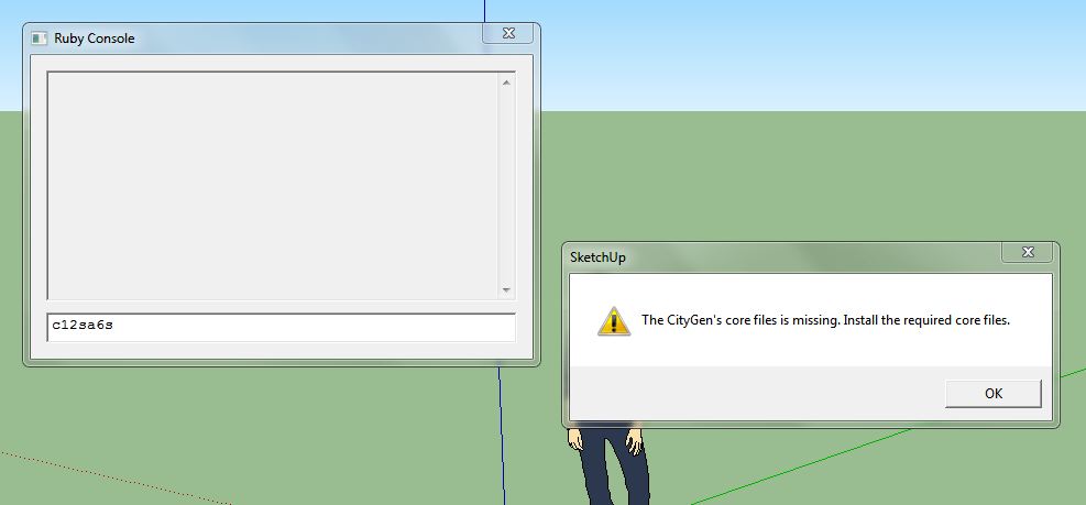

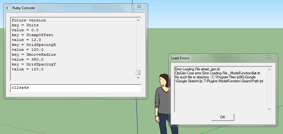

      Hi everybody,
      After cleaning out my plugins folder from a s--tload of unused plugins, these two windows pop up upon opening SU.
      Not that big a deal to X them out, but I'd like to get rid of them permanently.
      Any suggestions please. πŸ˜„
      Thanks in advance.

        You have erased the CityGen support folder, but left the main loader in place. Or at least part of the CityGen package.
          Thomthom to the rescue, Thank you.
          So how do I get rid of the main loader? I did a search and none of those items show up, or if easier, how would I put back what's missing, where do I now get CityGen, I can't seem to find it.

            I'd recommend you clean out all files related to CityGen. As I don't know the state of your current CityGen installation. It'll be quicker than trying to mend it.
            The CityGen project is a sub-forum under the Developers sections: http://forums.sketchucation.com/viewforum.php?f=314
            CityGen should be part of the filename ... though it's so long ago since I had anything to do with it that I don't remember. But if you re-download it you'll find the filenames in the package.

              All .rb files in the City_Gen folder are loaded by city_gen.rb.
              ..\Plugins\city_gen.rb === the 'loader'
              ..\Plugins\City_Gen\street_gen.rb === loaded by city_gen.rb
              ..\Plugins\City_Gen\Street_Gen\ === street_gen's support folder
              etc...

                  Apparently I had not taken out the city_gen.rb file πŸ˜• "DUH!" 😳 but all is well now, and all missing parts are now intact
                  and sitting in another optional plugins folder in case I need them .
