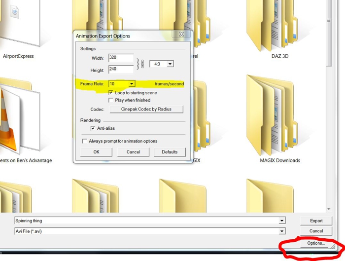

                • BoxB Offline
                  Box
                  You change the image size and frame rate in the Options section of the Animation export window.
