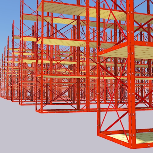

                I'd be tempted to produce a single rack unit in detail in SU then take ortho renders of it from all sides plus the shelving. You could then process these and paint them onto a plain box of the same dimensions. If you were to make the renders into transparent pngs...deleting all the negative space, you could even have the box still appearing as a fully 3D see-through unit.
                This little lot is less than 3000 faces

                  Alan thats very clever. I can understand how to get the pics onto the sides and remove the negative elements but how do you get the box to be see through and how do you get a different pic on each side of the box using the one material.
                  • Alan FraserA Offline
                    Alan Fraser
                    Just to the right of the racks you can see the original imported png file, which has the negative elements already depicted as transparent. I simply imported this (as an image), exploded it, then grouped it so it wouldn't stick to anything else. I had decided on a nominal shelf height of 5', so I imported the image 10' high...as it's double-stacked.
                    All I did then was trace a rectangle over the part of the image that represents the open front. I then measured the depth of the side image and Push/Pulled the drawn rectangle the same distance. You then have a box that is exactly the same size as the elements in the image, ready to take the projected textures.
                    Projecting the textures is simply a case of lining up the different elements on the image with their respective sides, sampling them (Paint Bucket + Alt) the painting onto that side. Obviously, this involves rotating the image (or copies of it) 90° so that you have front and side elevations + plan. You'll also notice that the planking on the image is a bit short for the shelf itself, so the copy that lay flat over the top of the box was stretched to make it fit. I have deleted the top surface of the box, as it's not needed when they are stacked...although I guess you could make a separate top shelf component with a cover on, if it's needed.
                    PS I didn't use SU to produce the original image; I simply drew them directly in CorelDraw and exported a transparent png without bothering to create an original hi-res 3D version, complete with rivets. It's perfectly possible to use SU...you'd just have to do a load of post-processing to composite the different elevations and remove the negative parts.
