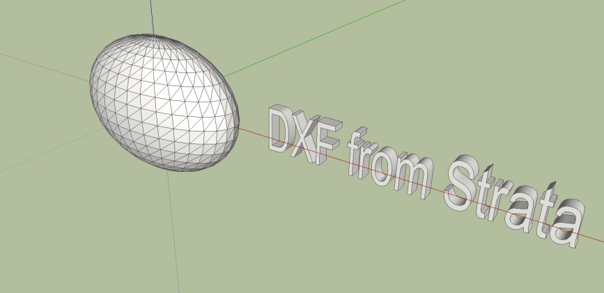

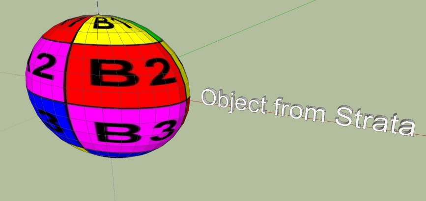

                Hi Frithioff,
                did you try to export the model directly from Strata as DXF or Obj? For me it works fine.
                Charly

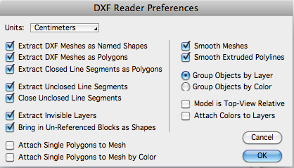

                    I tried to import 3-d objects directly from Strata dxf and 2-d planes in dxf in order to extrude.
                    Perhaps it has to do with the dxf reader preferences. I show the used ones. And the bad result in SU.

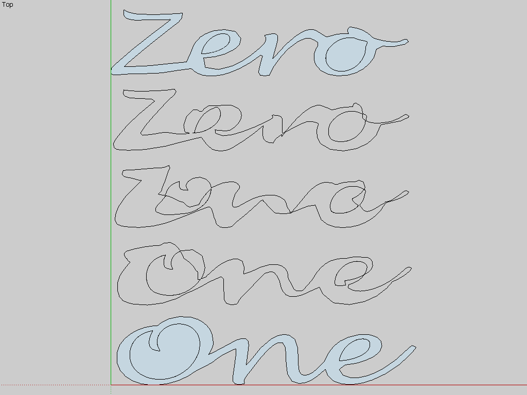

                            OK, so I got the below dxf file (zipped) from Fit (somehow he ended up with a PM) and imported it to SU and there is some interesting result there...
                            zero-one-blend-1 copy outline.dxf.zip
                            ZeroOne.skp
                            • TIGT Offline
                              Imported at 'meters' the outlines are pretty scrappy and although they'll take faces the edges are not draw well or consistently...
                              It would be easier to import an image and trace over it... 😒

                                • GaieusG Offline

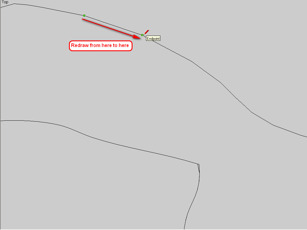

                                  Okay, first: the whole import comes in as a component. First right click on it and explode.
                                  Then zoom in and redraw a line segment from endpoint to endpoint.

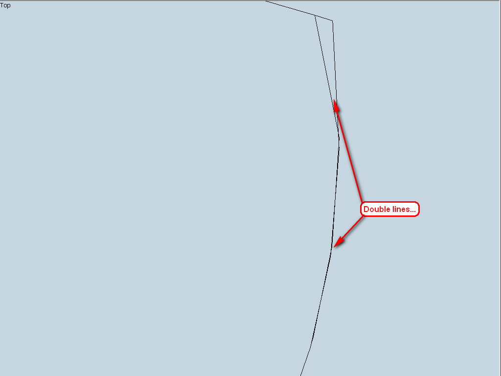

                                  Now you end up with the shapes filled - however the hole in the letters is also filled.
                                  There will be some clean-up needed here and there as you have double lines around these holes.
                                  Once you clean up and separate the faces in the holes, you can right click > Erase them and then simply use the PushPull tool to extrude them.
