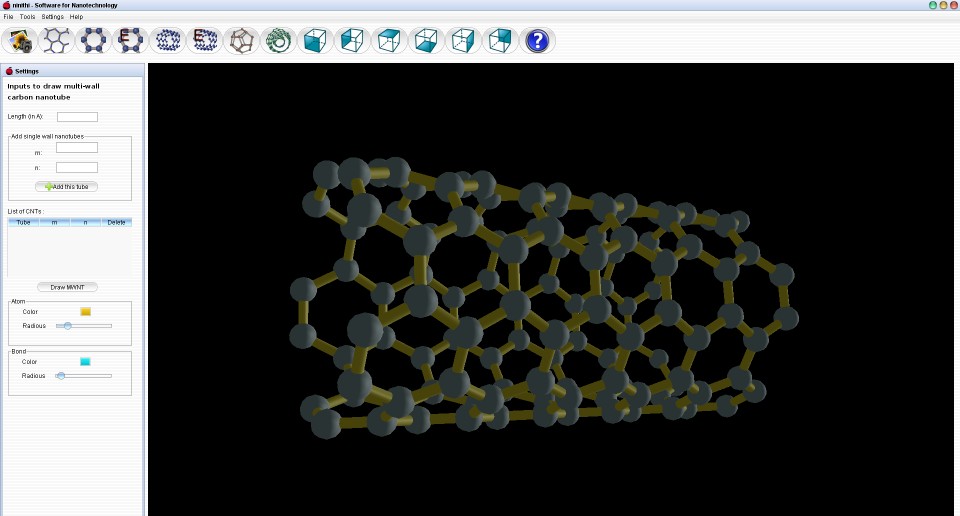

            A free one: Ninithi ๐Ÿ˜‰
            http://www.opensource.lk/images/Ninithi_3.jpg

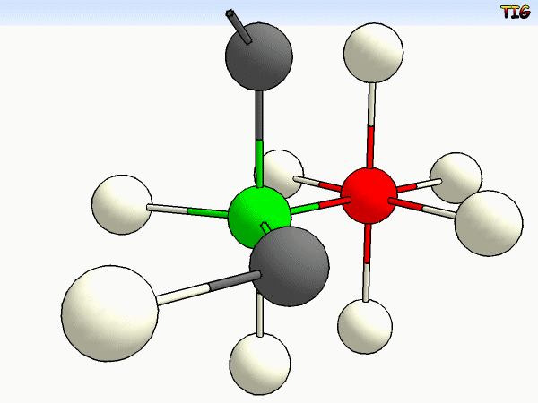

                    • TIGT Offline
                      Gurvan
                      Here's a simple SKP method.
                      I made a few 'Molecules [Atoms?] as components with different connection numbers/arrangements and then simply snapped them together, moved, rotated and mirrored [scale -1] as needed, finally I painted each one some arbitrary color - I'm sure there are standards for this !
                      The attached SKP contains a starter kit...
                      The 'movie' is a simple animation export from SUp made into a gif...
                      The parts themselves are static but there are several tools you could try within a SKP to 'move' them around too...MoleculeUp.skpMoleculeUp.gif
