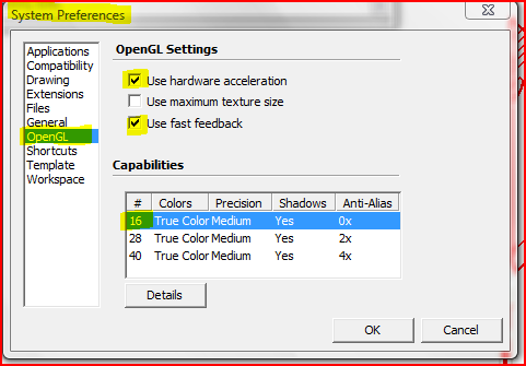

        • TIGT
          A screenshot would help a lot...
          Also... does this happen with all faces or just some ?
          If all then check your Graphics-card options and updated-driver... also Preferences > OpenGL settings. Try with some off etc to see what affect this has...Capture.PNG If it happens with just a few faces it could be z-fighting where there are coplanar faces inside groups etc and then the display has to decide which material to show, and it varies depending on the angle - this is fixed by either erasing one of the clashing faces or moving one a few mm away from the other so it doesn't happen...

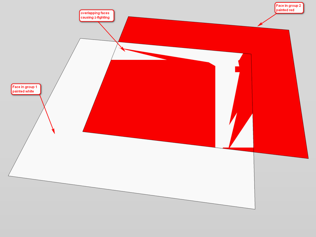

            That's what I would think, too. See attached example.
            z-fighting.skp
