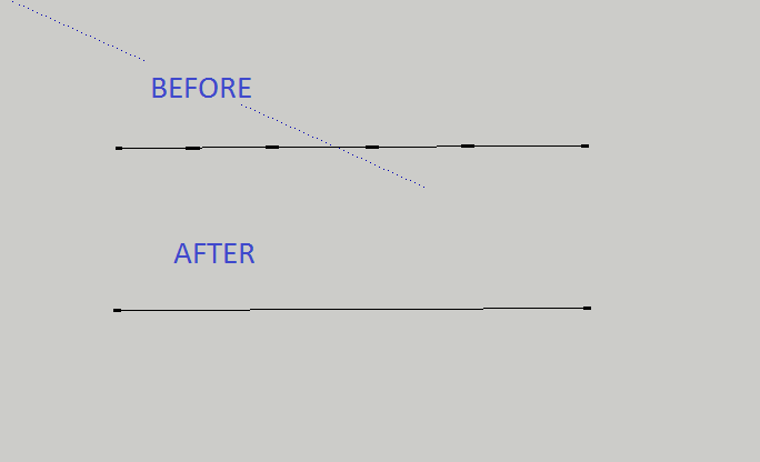

      PLEASE TELL ME A RUBY LIKE THIS

                to clarify, what is it you want to do? I believe his goal is to align an edge to be straight.

                  oh I see... the style was throwing me... he does want weld. he wants to connect multiple line segments. so Weld would be good. a must have for me.

                    Weld joins the bits of connected edges into a single bound curve, but there are still 'vertices' [ends] within that curve.
                    There are several other tools - as mentioned - that will 'heal' co-linear edges into one new edge, removing any intermediate unnecessary 'vertices' [ends]...

                      I dont know how to explain clearly. When I used 1000 bit tools, extend edge to edge the line was extend which create 2 segments so I want to delete this vertex to have one line. I don't remember that ruby. Sorry about my English. Anyway thanks you two.

                        Here http://forums.sketchucation.com/viewtopic.php?p=193587#p193587 gets the tt cleanup tools.
                        Remember to also download the required TT_Lib2 using the link just above the ,rb download...

                          Try "repair broken lines": http://rhin.crai.archi.fr/rld/plugin_details.php?id=334
