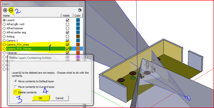

                        • TIGT Offline
                          Vegard
                          I've looked into this a bit more for you...
                          It's not that straightforward BUT it is fixable...
                          There are two other hidden groups inside the camera's group, they are called 'frustrum_rays' [several guide-line rays along th edges of the view 'box'] and 'frustrum_faces' [the planes that make up the camera's view 'box']
                          These are on both on their own layers that are switched 'OFF'.
                          Use the 'Layer Browser' to switch them 'ON' and you'll see what I mean.
                          Select both of these layers in the Browser and use the '-' button to delete them - using the option to delete the layer's contents - this will remove the two groups.
