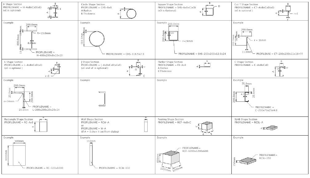

          I have only one problem with the 'default_pflist.csv' file.
          The editing of the file doesn't take any effect in SketchUP.
          Is anybody successfully added any new 'sizes'?
          I would appreciate your comments.
          Regards

              Hi There,
              I have seen the tutorial http://www.youtube.com/watch?v=oSVrbJMSSB0&feature=player_embedded and I have noticed that you can change the path to the *.csv file.
              I have created a new file, located on My Desktop and changed the path - it works! but... when I change to the plugins path it doesn't.
              Never mind, I like the fact that you can link own *.csv file and it can seat in my preferred location.
              Thank you
              Regards
              Regards, SU 'beginner'

                  Hi There,
                  You are right the file does not belong to the Desktop - it is my copy of the file from ...\Plugins\building_structure_tool folder to play with.
                  As I said - When I edit the file in the plugins folder I don't see any changes in SketchUP but...
                  When I edit the file on my desktop (outside the plugin folder - you can keep the copy of the file anywhere you like) and change the path in SketchUP I can see the changes (picture attached).
                  Path to the default_pflist.csv - now I will change to my Desktop copy and I will see my new steel, walls etc. types

                            Hi,SU Fractal and Beginer.
                            The File System of ruby in sketchup(windows) can not work well with path include the original characters of the language.
                            I tried the many method ,but I could not find good solution.
                            So the csv file about profile list locate the suitable folder whitch do not include the special characters.
                            This is as hard as possible.
                            Thanks.
