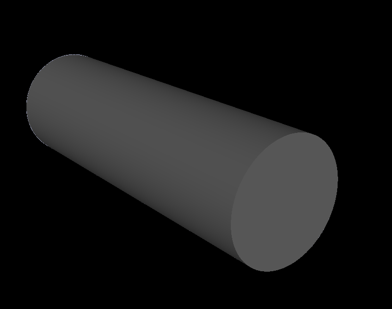

      I learned that you can change the style in which my SketchUp is displayed, to make it look like a Blue Print, or a quick sketch, or papyrus or whatever. I was wondering if there is a way to download or add a style to make it look like a space scene. Namely a black background, or even better a black background with small stars speckled throughout it.
      I tried to do so manually, but all my models wind up with this really annoying white line forming along the back lines. Visible here to the left side.
      http://i215.photobucket.com/albums/cc42/Edward_Wolf/Refference/RamaModel.png
      I wanted to do a simple model of the Rama spacecraft, from the Arthur C. Clark novel, and right off the bat this bug is just... killing the mood!

            Those "white lines" are the result of non-perfect antialiasing. The face behind the edges bleed through a certain extent. You will never be able to completely get rid of them - and they are just a bit noticeable on a black/dark bakground.
            When you export a 2D image, export it at a really large scale and it will be hardly noticeable. During modelling, just learn to live with it.

              As Csaba says, the white line is the back face color bleeding through. Although technically it'll still be there, you can minimize its effect by editing the back face color to black. I do this frequently when I have a style in which I'm getting that artifact. My default style uses a lime green for the back face color so it tends to be very visible with dark backgrounds.
