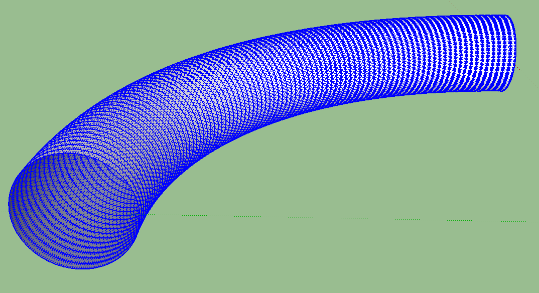

      I managed to acquire a new Acer x2 dual core processor equipped desktop computer with 3 GB RAM on it. I was sure this would be enough to handle anything I threw at it, sketchup wise.
      To my surprise, I was sketching up a simple torus and when I got to around 16 000 entities, it started lagging, a lot. I've only got a quarter of the torus done and I can barely copy the other 4 portions of it. I created very small polygons (180 rectangles per circle, with 360 circles) because I wanted a smooth surface, but I was sure my set up could handle it. Just how powerful a computer does one need to handle high polygon count for simple geometric shapes!
      Here's a screen-grab of the quarter I got done (un-smoothed so you can see the polygons).
      http://i215.photobucket.com/albums/cc42/Edward_Wolf/Refference/Step05.png

        Dual core is apparently not used by Sketchup application. However, a sprightly processor and a good graphics card with sufficient ram is necessary. Google actually does have both a minimum and a recommended system specification on one of its pages.

                If you're not sure what kind of card it has it's possible that it just has an integrated video card which can cause some issues. I had an old dell desktop that had lots of glitches when it came to sketchup until i bought a separate nvidia card to put in it.
                BTW, I know it's sort of a separate issue, but your poly count on that torus is almost definitely a lot of overkill. If you're sticking within sketchup, it's definitely overkill, if you're exporting it to a renderer then you should still be able to get by with a LOT less polys and have it look perfectly smooth and round so long as your polys are smoothed in SU the renderer should smooth out the lighting so at that point, you just need enough divisions so that you can't see any sharp edges at the glancing angles.

                  The number of longitudinal divisions for a cylindrical form could be as few as 8 to 12, maybe less in some cases. Or as much as in the 20s.
                  This all has to do with how close up your rendering view will be to the model and comes with experience.

                    Wait, what do you mean when you say longitudinal divisions? The segements in the circle come as a default 24, so do you mean the number of circles that will make up the torus? Because 8 seems like far too few...
                    Basically what bugs me is when I take a simple geometric shape (like a cylinder), and then try to make it into something useful (like a rocket ship). As soon as I zoom in to add a window or a sensor node or a hatch or anything, the edges of the polygons that make up the damn thing become glaringly obvious. Maybe these segmentations can be fixed by rendering, but honestly I've... never rendered. I've always worked through SketchUp.
                    But thank you, that's what I wanted to hear. Either, "Only 16000 and you're starting to lag, hooo boy, it must be your computer." Or "16000 man! Are you daft, no one should ever have that many polygons." Or... "entities", whatever. Point is, my model was excessively rich in polygons, so next time I'll try to dumb it down.

                      I can see that reference to longitudinal was maybe not the best. Look at it this way: Say you make your cylinder first by making a circle with the circle tool. While you're making the circle you have the option to set the number of segments representing the circle. I think the default is 20, which you can alter after the fact and before you extrude the cylinder. Each vertex on the perimeter of the "circle" would be what I was calling the longitudinal on the extruded cylinder. As for the circle, Sketchup, in the interest of program simplicity, creates a polygon to represent the circle. As I said, it simplifies a lot of things, but creates difficulties in other ways. A great deal more can be said here than there is room or time, and there are plenty of posts and publications regarding this. A good investment would be the book by Bonnie Roskes on Sketchup done around Version 6, maybe late 5, if there is not a later edition.

                        Yeah, I'd say the issue is more in the modeling. I'm not quite sure I understand what sort of polygon issues you're seeing even with the description. Maybe a screenshot would help. I will say that how sketchup handles circles can cause issues like those you're talking about. Most people don't adjust the default number of segments at all and 24 segments can certainly be noticeable at certain angles. However, I'd expect those issues to disappear long before you get to the levels you're talking about - particularly because SU's shading can be more forgiving than a renderers.

                          I will sometimes use 48 sides to create a circle, which works out to a new face every 7.5 degrees -- at the default 24 sides you are getting a new face every 15 degrees which is probably the lower threshold for something of a decent size to appear smooth, even with smoothing (Gouraud shading).
                          I don't see much reason to ever go above 72 sides on a circle, and would only go that high if the smooth qualities of the cylinder/circle was a primary element of the model -- or the model was huge and was to be viewed close-up.

                            Something else to keep in mind -- the higher the amount of sides you have the lower you can have the smoothing angle set... the smoothing function does take some system resources for rendering so a lower smoothing angle will tax your system less.
                            It's easy to determine the needed smoothing angle -- just divide 360 by how many sides you have.
