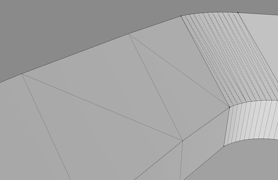

                    I think the problem I'm having with the plugin is I'm giving it too much to do (or my computer sucks, whichever). If I just do one or two arc edges, or give it something simple like the outside frame of the door, it finishes it up no time flat. But if I try to do the entire edge loop around one of my frames, even with just two segments, it freezes up and says it's computing for an endless amount of time.
                    To clarify a little more, what I'm trying to do is this. Just a small rounded bit to smoothen out the rough edge. I could delete everything I've done below and make it flat again, add 2 or 3 offsets, and use the push and scale tools to make some segments manually, but I'm still trying to find an easier way to do it.

                      if you don't mind, could you upload the .skp ?
                      there might be something wrong with the geometry that's causing the hang.. it's hard to tell from the screenshot.

                            yeah, it's not going to work.. all of those triangles are causing the problem.. if you took the triangles and exaggerated the angles, you'd see how twisted the surfaces are in certain spots.. i'm not positive but the tight corners may be too heavily divided or too small of surfaces for the surface to generate there..
                            i'm not quite sure how fixable the model is at this point.. i'd personally start over but someone might come up with a better solution than that πŸ˜„
                            [future reference, you can upload .skp files directly to this site using the 'upload attachment' tab at the bottom of the 'post a reply' window.]
                            with hidden geometry turned on, you can better tell what's going on...
                            [and actually, the more i look at this, the more areas i can see that are going to cause weirdness.] but hey, it's friday night and i don't think i'm in the best state of mind to explain things.. i'll try again tomorrow if someone else hasn't already cleared it up.

                                  back to matt though.. really, what you're drawing there is possible in sketchup but it's way more involved than a simple chamfer with rounded edges.. the angle of the bevel is constantly changing (at least how you have it drawn.. not sure if you're intending for it to look that way or not).. are you wanting a consistent bevel all the way around or are you aiming for the change in angles?
                                  dotdotdot
                                  • R Offline
                                    Renzatic
                                    Hmm. If I'm reading you right, the angle of the bevel should be consistent across each edge loop. I've got a few tight turn spots in there, but there shouldn't be any places where it'll rotate to a different facing or get wider or skinnier. Or at least there shouldn't be.
                                    So yeah, consistent bevels all the way.
